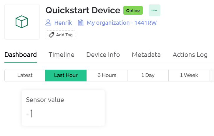

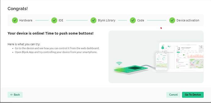

Okay before I saw your answer I got it working, and it actually works as I thought it should.
Here is a short resume of what I did.
From Blynk website I used the Quickstart guide to get the setup sketch.
I copied it into Arduino IDE, choose LOLIN(WEMOS) D2 R1 & mini board.
Set the DIP switches 5,6,7 to ON
Uploaded the sketch.
Switched DIP 5,6,7 back to OFF
That's it.
It connected immediately.

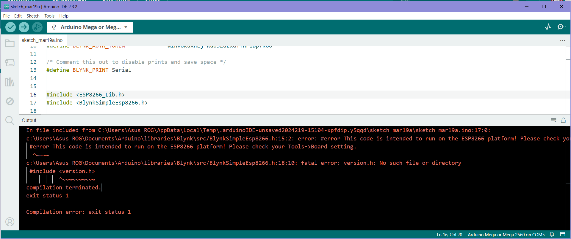

I set the DIP switches 1-2-3-4 ON, choose the Atmega2560 board and when uploading sketch, I get the error that <ESP8266WiFi.h> isn't found.
However if I choose LOLIN(WEMOS) D2 R1 & MINI board it doesn't give the error and attempts to upload but of course it would fail because it can't find the ESP module because the DIP switches is set wrong.

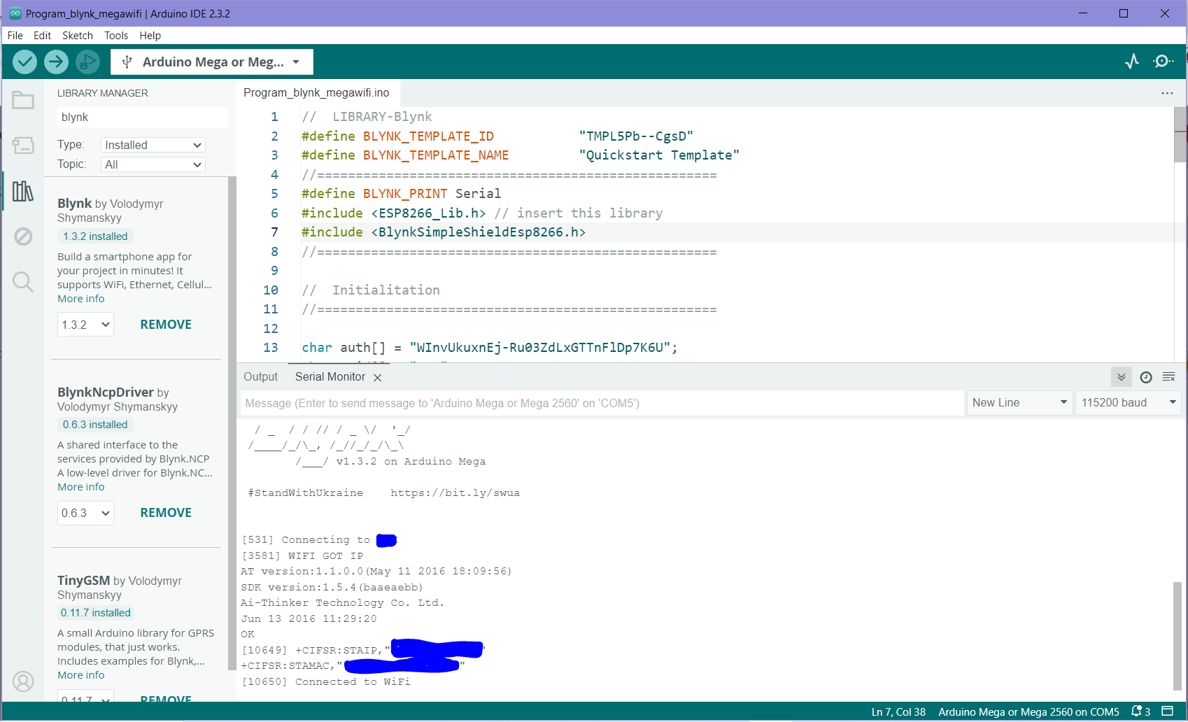

Another thing I have tried is of course uploade the firmware to the ESP and then using the old 0.6.1 version of the Blynk library were instead of using in the example sketch <ESP8266WiFi.h> it uses <ESP8266_Lib.h>
Then I can set the DIP switches 1-2-3-4 ON and upload this sketch to the Atmega2560 and it will work.

Okay so in the new example sketch, I need to replace ESP8266WiFi.h with ESP8266_Lib.h?

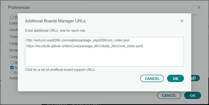

Making sure to have the boardURL for the ESP8266:

Choose Atmega2560 pressed upload and that's it I can't get any further:
Tried replacing ESP8266WiFi.h with ESP8266_Lib.h:

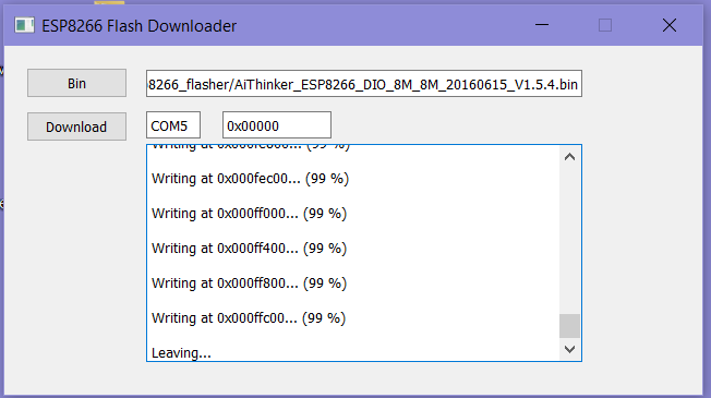

Next thing I try is the Blynk firmware method. I Flash the latest Blynk firmware to the ESP8266:
ESP Firmware
Then when using the old 0.6.1 version of the Blynk library and upload the old sketch from the youtube video to the atmega2560 it works no problem, but as you can see it only connects to Wifi not the Blynk server and thats it:
I can also upload the sketch with the new version 1.3.2 of Blynk, I just need to add Template ID and Name.
But again it doesn't connect to the server. Only the wifi connection.

Are you even looking at the screenshots?!
I flashed the blynk firmware to the ESP8266, done.
THEN I copied the sketch from Blynk website and tried uploading it to the Atmega2560 but it keeps failing. I can't upload the Blynk sketch to the atmega because it keeps asking for ESP8266WiFi.h you would see that if you looked at the screenshots.
So let me say it one more time I CANT UPLOAD THE SKETCH TO THE ATMEGA2560.
