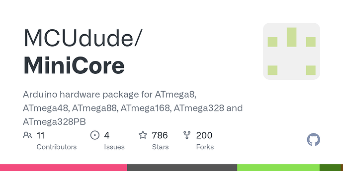

The list of programmers AFAIK should be populated by the core you installed. Looking at the options, it seems as if you're using MiniCore. In that case the list of programmers should definitely be populated. Have you tried reinstalling this core/board?

The Arduino IDE's handling of the Tools > Programmer menu changed in the time since you were working on your project last:
This change means that each standalone Arduino boards platform must provide its own programmer definitions, as opposed to the old system where all programmers of all installed boards platforms were listed.
The recent versions of MiniCore do define its own programmers, so if you are indeed using MiniCore then you only need to update to the current version:
Thanks. I'm embarrassed to say the chip was in backwards! A fresh chip still shows the "no programmers" but the bootloader burns ok. I believe 20mhz is legit for the 328.(the 328p in the image is just from me poking around).
I will update the minicore and hopefully avoid future confusion.

Oh, and when updated the boards manager the programmers showed up.
