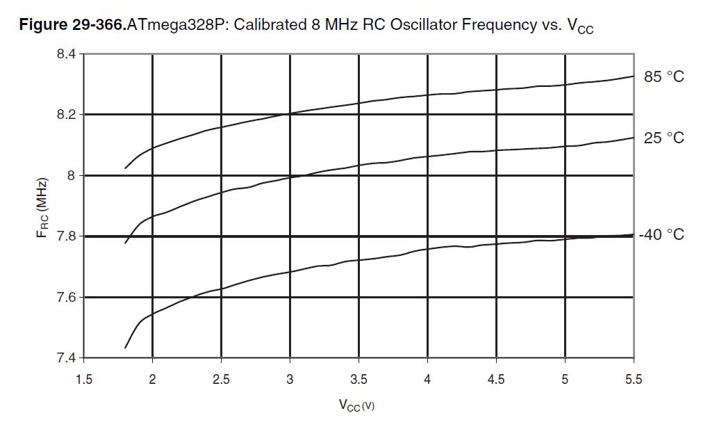

The frequency of internal "8MHz" oscillator varies with the voltage. It is set by manufacturer to 8MHz at 3.0V.
So the clock frequencies at 3.3V or 5.0V will be different.
The blink shall work at both voltages, what could be an issue is the Serial, which reliability depends on the proper clock frequency. So the serial upload may not work.
What is your upload serial speed there?
