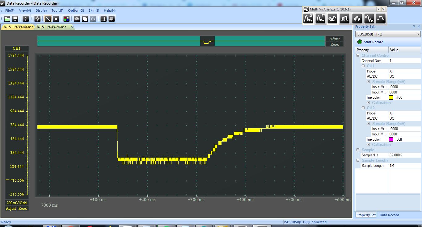

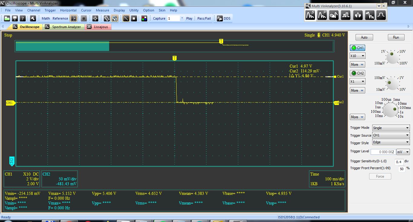

Can you get a scope trace on the Reset line? That 10uF might be keeping the Reset line up too long.

Here they are, I made a screenshot with a single trigger and cursors, but you can't see much after the trigger, so I also tried data recorder. I also made a shot without the external 10uF on the Arduino reset-GND lines (note that I have a 10uF and a 100nF to GND on the Atmega reset).
