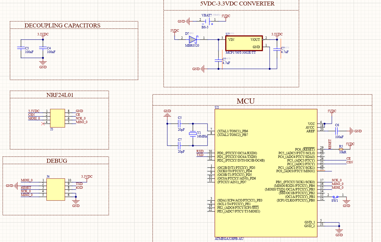

Hello, I want to communicate with the nrf24 module using the atmega processor. There is a receiving side and a transmitting side in the circuit. I am using esp32 and nrf24l01 module on the receiving side. There is Arduino nano and nrf module on the transmitter side. The system works flawlessly as it is. However, when I connect only the circuit of the atmega328pb processor and the spi pins of the nrf module on the transmitter side, after energizing the processor, it cuts off communication after communicating with the receiving side 2 or 3 times. What could be the reasons?

but when i use arduino nano there is no problem

you mean you just connect a naked chip?
Yes but, TQFP32 Package. here is the my schematic of PCB
After programming with USBASP, I connect the spi pins to nrf
