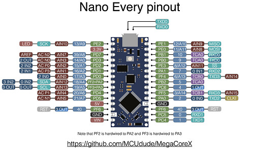

The four USARTs are:
  • USART0 - Not described in Arduino documentation, this uses D2 for TXD, D7 for RXD, A4 for XCK, and A5 for XDIR. This is the only USART with full signals directly available on the board.
  • USART1 - This is device Serial1 in the Arduino library and uses D1 for TXD, D0 for RXD, and has XCK available on D4. This uses alternate pins which must be set in the port multiplexer. PORTMUX.USARTROUTEA |= PORTMUX_USART1_ALT1_gc.
  • USART2 - Not described in Arduino documentation, this uses D6 for TXD and D3 for RXD. Alternate pins are used which must be set in the port multiplexer. PORTMUX.USARTROUTEA |= PORTMUX_USART2_ALT1_gc.
  • USART3 - Connects to the USB interface and is device Serial in the Arduino library. Signals not brought out on the board.
So basically it's USART0 and USART2 that you can use that the library doesn't support off the shelf. There is code dangling around in the library core that might be possible to enable. I haven't tried it. It looks like it can be accomplished by adding lines to nona4809/pins_arduino.h for HWSERIAL2 (USART0) and HWSERIAL3 (USART2) following what was done for HWSERIAL1 and HWSERIAL0. I always access the ports directly.

You get access to all four serial port and much more by using MegaCoreX.
