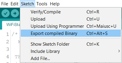

Is there any way after sketch compilation via IDE to export/copy the .bin executable file in a specified folder (the emulated flash disk) ? maybe using a “custom programmer” that just copy paste the .bin generated file to the target folder
Idea is to use IDE for compilation and that use a drag and drop approach of the .bin file with a MSD bootloader

Justin Mattair has ported an MSD bootloader to the Samd21 chip. You can find it here. You'll need an Atmel ICE (or any other JTAG programmer) thhough.
To "generate" the binary file from you program, click on Sketch->Export Compiled Binary. It will put the .bin file in the same folder as the Arduino program.
oops...it was under my nose and I don't realize this "export compiled bianry" menu for so many time ( I think is there since few IDE releases ! great simple feature

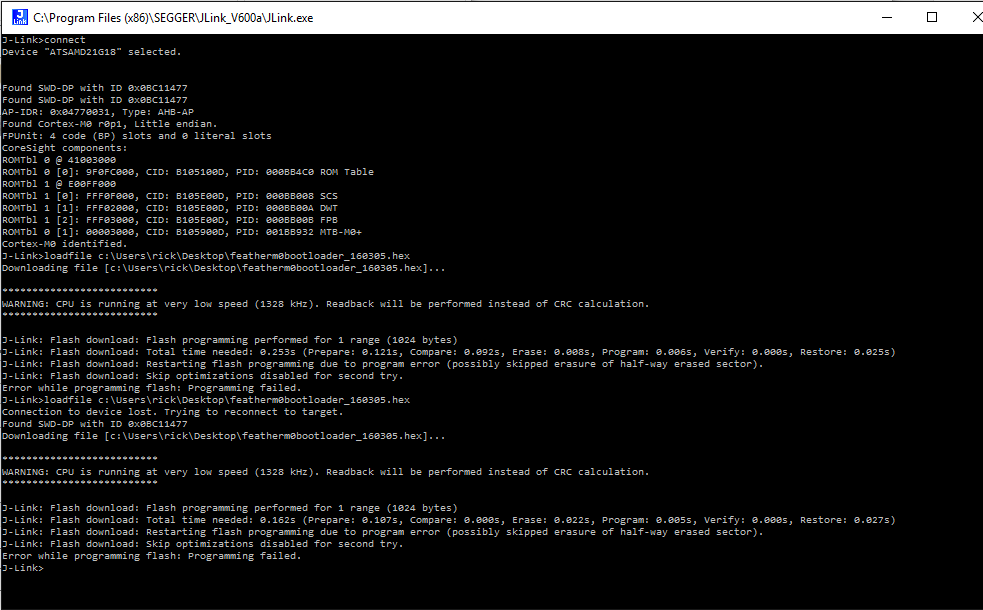

@AloyseTech I've been tearing my hair out trying to program the Adafruit Feather M0 bootloader with the Segger JLink. I have read the Adafruit debugging of ATSAMD21 processors Overview | Proper Debugging of ATSAMD21 Processors | Adafruit Learning System.
I have tried doing it via Atmel Studio 7 and directly with the JLink.exe software for the Segger JLink. I get the attached error message.
Interestingly, I can read the memory of a fresh board that still has the Adafruit burned bootloader fine, but as soon as I try to use AS7 to debug a sketch, the bootloader is overwritten with 0xFF's. I can also use the w1 command in JLink to write a byte in the M0 flash and it reads back successfully. As soon as I try to write the whole bootloader .hex file, I get the attached error. I have tried slowing the JLink speed down to 1000 kHz and even 500 kHz, but same error occurs.
I'd buy the Atmel-ICE Basic board if I have to, but the JLink should work too, shouldn't it?
Thanks for any ideas.

rickrcomm:

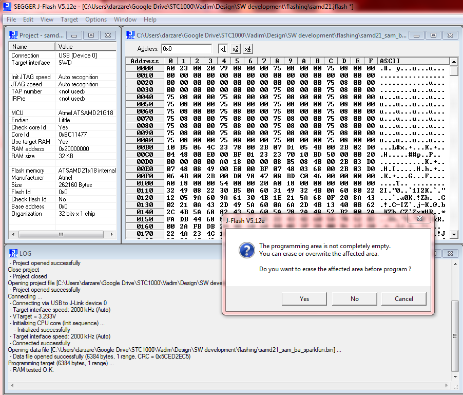

I follow up this since I have similar issue with one of my custom board with SAMD21G18
I was thinkig that could be my specifc and local issue (some HW problem or some corruption on the flash doing many experiments) but from Rick post seems a common issue
I connect SEGGER J-link via SWD interface and I try to load bootloader (modified SAM-BA from sparkfun) from location 0x000 but if I do Program&Verify I’m propted that the program area is not empty and if I select to overwrite (answer YES to pup up) the programming process fails and here is the log
  • Erasing affected sectors ...
    • Erasing bank 0, sectors 0-24*
    • ERROR: Blank check after erase reports: Failed to erase sectors 0-24 (0x00 - 0x18FF) @ address 0x00*
    • ERROR: Failed to erase sectors*
      - ERROR: Failed to program and verify target
If I answer no to overwriting the area the process end successfully :o
RAM tested O.K.
- Programming target (6384 bytes, 1 range) ...
    • Target programmed successfully*
      - Verifying target (6384 bytes, 1 range) ...
    • All loaded bytes verified OK!*
But then when I load the application from address 2000 it doesn’t work at all (same binary on another board works perfectly)

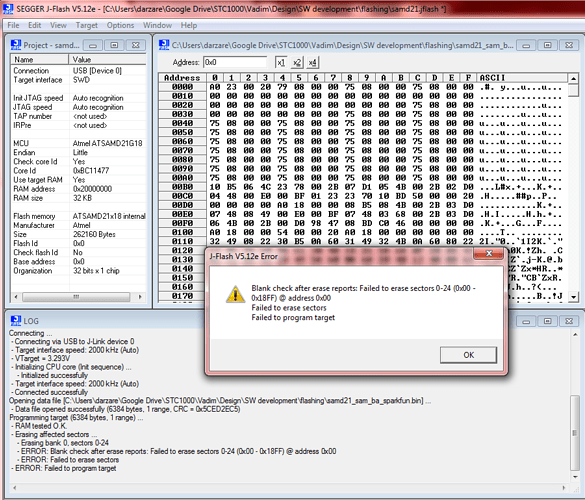

If I try to erase chip I got again an error :frowning:
Erasing chip ...
- Erasing 1025 sectors, 2 ranges, 0x0 - 0x3FFFF, 0x804000 - 0x80400F
- RAM tested O.K.
- Erasing bank 0, sectors 0-63
- ERROR: Blank check after erase reports: Failed to erase sectors 0-63 (0x00 - 0x3FFF) @ address 0x00
- ERROR: Failed to erase chip
Do I have something corrupted in the SAMD21? Is there any way to erase completely the flash?
I try also by command shell and command line but error are the same..
Attached some screenshots
Davide
I'm not familiar with the J-Link devices, but one line that caught my eyes is :
WARNING : CPU is running at very low speed (1328kHz).
Maybe you have an hardware issue with the clocking system. I'm not sure though. Sorry I can't really help on that matter...
The Bootloader section is fuse protected. You need to disable it first in order to be able to "erase" that seciont.
In Atmel Studio: tools -> Device Programming
Selct your J-link, Make sure it can read the device ID
Look into the FUSES section, Edit the BOOTPROT...
Section 22.6.5 http://www.atmel.com/Images/Atmel-42181-SAM-D21_Datasheet.pdf
I too postponed the ready of those 1000's pages until I could no longer avoid it !
Luckily for you, the boot prot section is the shortest :wink: 1 paragraph and 1 table
