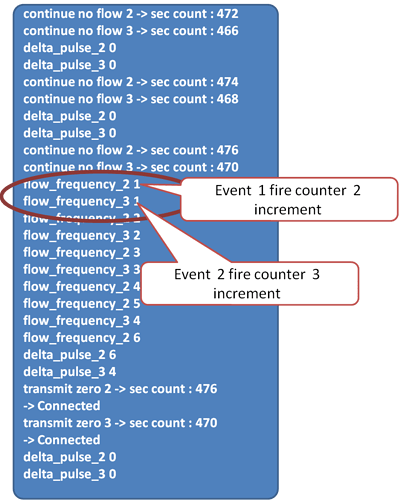

I'm trying to detect two encoders with AttachInterrupt event using Arduino Uno module.
The code attached
void flow(){
flow_frequency++;
void flow_1(){
flow_frequency_1++;
void setup(){
pinMode(2, INPUT);
attachInterrupt(digitalPinToInterrupt(2), flow, RISING);
pinMode(3, INPUT);
attachInterrupt(digitalPinToInterrupt(3), flow_1, RISING);
sei();
When the input 2 is rising the event "flow" trigger and also event "flow_1" is trigger which cause to flow_frequency_1 parameter to increment and it is worng.
When input 3 is rising event "flow_1" trigger and event "flow" not trigger which is ok.
Please advise ?

Do you have a data sheet for the encoders? Some encoders have an open collector output so need a pullup resistor.
Thank you for your reply.
They are two simple water flow sensors connected to input 2 & 3
I tried to put 110 Ohm resistor without any help
Any idea ?
Thank you
Yalon
Pull up resistors are generally in the 5K to 10K range.
I tried these type of resistors without results.
It seems to be bug that causes the event 1 to trigger the event 2 ??
Any idea ?
Thank you
Yalon
ygnd:
It seems to be bug that causes the event 1 to trigger the event 2 ?? Any idea ?
I suspect problems/bugs in the code you do not show.
A circuit diagram would be useful.
Have you avoided ground loops?
Do you have a link to your water flow sensors?
The sei(); from the snippet shows that there are misunderstandings in the whole interrupt system.
Post the whole code, to make shure it's no handling problem.
If you are wiring things correctly and using pull-up resistors the two inputs will be independent,
therefore you haven't wired things up correctly.
Show the circuit and the code if you want more than guesswork, as has been carefully detailed
in the "how to post to this forum" threads.......

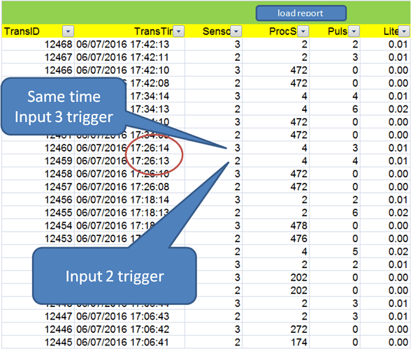

Typical output : when sensor 2 fire also sensor 3 fire
TransTime input ProcSec Pulses Liters
05/07/2016 18:54:07 3 474 0 0.00
05/07/2016 18:54:05 2 474 0 0.00
05/07/2016 18:46:09 3 2 3 0.01
05/07/2016 18:46:08 2 2 1 0.00
05/07/2016 18:46:06 3 474 0 0.00
05/07/2016 18:46:04 2 474 0 0.00
05/07/2016 18:38:09 3 2 4 0.01
05/07/2016 18:38:07 2 2 3 0.01
05/07/2016 18:38:06 3 474 0 0.00
05/07/2016 18:38:05 2 474 0 0.00
05/07/2016 18:30:09 3 2 5 0.02
05/07/2016 18:30:08 2 2 4 0.01
05/07/2016 18:30:07 3 474 0 0.00
05/07/2016 18:30:05 2 474 0 0.00
05/07/2016 18:22:09 3 2 1 0.00
05/07/2016 18:22:07 2 2 2 0.01
05/07/2016 18:22:06 3 474 0 0.00
05/07/2016 18:22:04 2 474 0 0.00
05/07/2016 18:14:08 3 2 4 0.01
05/07/2016 18:14:07 2 2 3 0.01
05/07/2016 18:14:06 3 474 0 0.00
05/07/2016 18:14:04 2 474 0 0.00
please see diagram attached
Looking forward to your comments
BR
Yalon
Do not use Serial.print in an ISR.
Do not disable interrupts and use Serial.print.
Read about interrupts Gammon Forum : Electronics : Microprocessors : Interrupts
I did the changes as posted in #10 but the behavior remain the same
I also added the monitoring image of the counters (before the change)
Any more idea ?

How can a different second be at the same time?
To work with multi-byte-valatile data, you have to make a copy with interrupts disabled.
This is true both for reading and writing.
Your sei(); in setup is superfluous, interrupts are enabled in that state already.
The time come from the server (when it receive the request) and there is delay of a second between the transaction of sensor 1 to db and sensor 2 to db.
see in the end of "void send_data_to_server()"
but we could see in post #9 the in the arduino_events_output.png attached file (before the change)
that both counters raised before entering the main block
