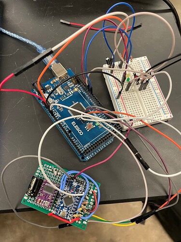

First, some photos:
For context, this is a perfboard for a Nerf blaster controller: it's meant to drive a stepper scotch yoke pusher, two outrunners with flywheels attached. It takes connectors from the trigger switch, pusher limit switch, ESC signal lines, and stepper. I made one huge blunder that I didn't realize until I finished the whole board: what I was reproducing wasn't meant for a 8MHz Pro Mini. Sure, it was 3.3V, but that mostly isn't a problem, but the ESCs have been reflashed to a fork of SimonK made for Nerf flywheel drives and the designer has his doubts on whether the ISR-based speed-control will hold up. This seems consistent with the error codes I get (and interpreting the order of the included selftest() function) when trying to power my build on: 3 beeps followed by 3 other beeps: no speed feedback.
His firmware is hosted here, I've made appropriate edits to it on my own for reassigning pins/removing unimplemented features and changed register read/write values as appropriate too.
I've checked over my wiring on some of the key problem points multiple times, and also for my attempts to reburn my Pro Mini with ArduinoISP, running continuity checks and double-checking pin assignments on the SPI bus. It is still possible that I've gotten something wrong there, but I most likely will need 16MHz either way and I'll cross those bridges when I get to them.
A possible workaround proposed (without needing to do the fussy operation of desoldering the entire board) was to reburn the fuses on my Pro Mini to enable the internal RC oscillator and just run it off my 5V buck. I was hoping to raise the target frequency and set the fuses in one fell swoop with this method, by editing my boards.txt file. I've had some problems with that: adding a board definition seems to omit the entire AVR board section from my IDE until re-installed, and I can't currently be confident that my changed board definition would match. That's most likely just another problem with a bridge I'll want to cross when I get to it.
So, I wired up everything and no dice. First, I tried swapping between pins 50-53 on the Mega to the ICSP. Then, I tried selecting the 3.3V 8MHz processor just to make sure that Arduino IDE wasn't just getting unhappy about me trying to "trick" my board. After that, I went through the process of disabling auto-reset with a 120 Ohm VCC to Reset line. Just to try it out for good measure, I also added a 100 nF cap between Reset and GND. At this point, I was getting a device signature of 0xffffffff, to which I realized I needed to cut VCC and ground lines on the perfboard: they led VCC into a set of pull-ups and pull-downs that were on pins 11 & 12 (which were being used for SPI). At this point, I'd ended up with the following verbose output:

I've heard that this can be caused by the system clock not running, which I thought was especially relevant as switching from the resonator to the internal RC was exactly what I wanted to do. I've tried to implement Adafruit's modified version of ArduinoISP but wasn't quite as confident in finding documentation on it and am not sure if that code might need some changed assignments for a Mega or how to exactly feed the clock signal into a Pro Mini in particular.
In between all of this, I did try pinging the Pro Mini through cmd and avrdude, to which I wasn't able to get a programmer response.
At some point, I'd be willing to try to extract my 3.3/8 Pro Mini and even redo the entire perfboard with a recently shipped 5/16 one, or just buy off a PCB made for the same blaster by a local club member. Before that, I wanted to make one final effort to try and save this Pro Mini.
Sorry if I've rambled on this topic. Though I've worked with embedded projects for years I've never quite sat down and learned all the nuances (or retained enough from the limited amount of courses at college available on them), so quite often in situations like this I realize I'm still a noob.
This seems to be a problem. I did not study it into the details but I think, you have "a lot on the plate" at once. If something not working as expected, keep it simple. The 6 ISP wires are essential. Get rid of LED indicators. I would disconnect everything from Pro Mini too, even if it is soldered.
