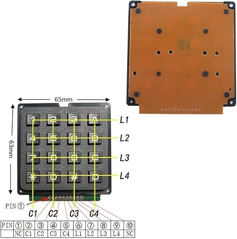

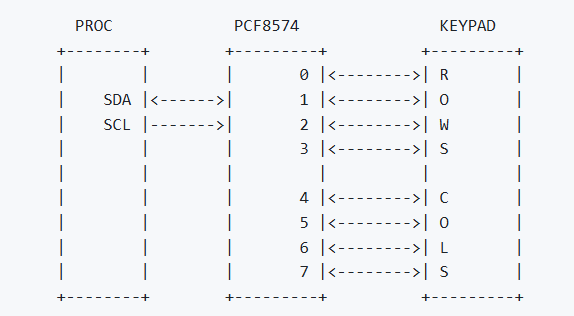

const uint8_t kbdRowPins[ROWS] = {3,2,1,0}; // P3..P0
const uint8_t kbdColPins[COLS] = {7,6,5,4}; // P7..P4
This is giving me the incorrect numbers when I press a key.

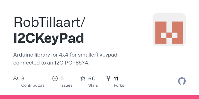

have a look at my library, and check if it fills your needs
I did try to use your library, which led me down this path to having an issue with the key mapping. As you have stated in your README file, the pins P0 - P3 are for rows and the P4 - P7 are for columns, which are true in my case but instead of P0 = Row 1…P3 = Row 4, my keypad is the reverse, and the for the columns P7 = Column 1… P4 = Column 4. How would you change that key map so that when I press the “8” key, the number 8 is displayed on the LCD display?
The library the seller links to has exactly this key mapping. Check the correct connection to the PCF8574 ports.

So is it that you do not realize that with a different row/column order, you need to change the numbers in these two statements, or is it that you want us to somehow imagine the correct order, and tell you what it should be?
In the code that I included, I have it coded like the last part that you have listed. Maybe my question is in library that I was using for the PCF8574 (I have switched from Adafruit_PCF8574 and tried using I2CKeyPad, but got the same result) how do I go about changing the PCF8574 pin assignments. In the README document for I2CKeyPad library the creator states the following;
Which he does say that it may take some effort to get the correct pins connected.
I do not want someone to do the work for me, I just need some guidance on how it is done.
No, I have changed the numbers for the pins to the correct Row and Column numbers and I am still getting errors. I am wondering if there is some coding snippet that I am missing to allow me to change the pin designations on the PCF8574.
I don’t want someone to do the work for me, I just want some guidance.
If it was me, I'd look at the keypad using an ohmmeter, find out what keys relate to what rows and columns that way.
But this should be a clue:
Note that the first and last pins aren't connected, leaving you with C1..C4L1...L4
If that's not what you're looking for, tell us more. If you're still getting wrong keys, perhaps listing all 16 results would help us sort you out. Something like
1-7 2-8 3-9 A-C
4-4 5-5 6-6 B-B
7-1 8-2 9-3 C-A
- 0-0 #-# D-D
would, for example, indicate that rows 1 and 3 are swapped. It gets more complicated when there's a mix of rows and columns swapped, or jumbled.
@jpfrancis690
Regarding the I2CKeyPad library, please run I2Ckeypad_demo01.ino
This sketch has a line ``char keys[] = "123A456B789C*0#DNF"; // N = NoKey, F = Fail
If you run this sketch and presses keys, it shows the index it returns and the translated key.
That shows how the mapping is done.
Please post the output of the sketch with all keys pressed once
Assuming you have mirrored the rows you should replace the line above with another one to match the actual mapping. I expect something like this:
char keys[] = "*0#D789C456B123ANF";
It seems like they just swap places
const uint8_t kbdRowPins[ROWS] = {4,5,6,7}; // PCF8574 pins for rows
const uint8_t kbdColPins[COLS] = {0,1,2,3}; // PCF8574 pins for cols
OR
const uint8_t kbdRowPins[ROWS] = {7,6,5,4}; // PCF8574 pins for rows
const uint8_t kbdColPins[COLS] = {3,2,1,0}; // PCF8574 pins for cols
