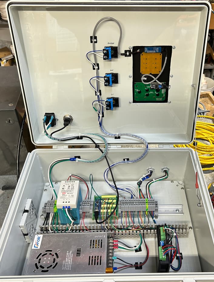

Help with PCF8574 for a 4 x 4 keypad failing to enter values
I am hoping someone will have an idea where I went wrong. In a project I am working on I have coded a I2C 4 x 4 keypad for a user to enter a value and have the sketch store that value upon entering the ‘#’ button and clear that value when the ‘*’ button is pressed. I have completed whole sketch and after some debugging after compiling I have uploaded the sketch to the Nano Every I am using and though the I2C 4 x 20 Display seems to be working properly, I cannot get any values I have entered in with the keypad to display. I have only included the parts of the code for the 4 x 4 keypad below and any supporting code due to the sketch being complicated.

When debugging, in the char scanKeypad() function, it originally looked like this

With the ‘pcf.” in the code, it was giving me errors upon compiling, but when I removed them, it compiled without this error.
I was hoping someone would provide some guidance on where to look. If I need to, I can upload the entire sketch if that would help.
Thanks,
And those errors would be...?
Have you tried using the Keypad library?

Did I forget a step in setting up the Keypad for use with I2C?
I did not think that the keypad library had I2C functionality. I will check on this.
There are different libraries for the pcf8574/5.
I think it is the Adafruit library which has the .digitalRead() and digitalWrite() syntax.
#include <Adafruit_PCF8575.h>
#include <Adafruit_PCF8574.h>
I'd have tried compiling your entire sketch, but it seems to be absent. As is a MRE demonstrating the alleged problem.
So I made a simple sketch that calls some of the functions in the PCF8574 library.
It compiled for me just fine with a Nano Every selected.

Does it need to have I2C? You are already using 8 pins on the Arduino.
As I stated previously, I only included the keyboard parts. Please see below for the entire sketch that I took the initial keyboard code from.

As the last responder has coded, I do not see any difference between what I had and what that contributor has provided. I saw in another thread that there could be more than one instance of the library and I will need to check that.
When I came up with the design, I was attempting to reduce the wiring burden overall and make it more streamlined. (see below for pic of cabinet)
In the upper right hand side of the picture is the keyboard and LCD mounting plate. If you look at the Nano Breakout board, it is already quite busy and I do not have enough terminals to direct wire a keypad, therefore I2C communications.
I see, nice layout too, very clean.
Thanks, I try to keep the technician in mind when I design equipment.

I do not understand the comment of I2C is not a wire bus. Theoretically, one could attach up to 128 devices on the bus due to addressing, but there is also physical limitations, which the primary limiting factor is bus capacitance (limited to 400 pF if I remember correctly). The I2C devices I have researched can only support a small number of configurable addresses, so that is another limitation.
In my use case, the cable I am using is not too long for this application and after further troubleshooting I have determined that the keyboard wiring to the solder pads does not match the desired PCF8574 pin assignment for keypads. I will need to somehow change the keypad mapping so that the correct columns and rows are read properly.
Common usage of I2C is to connect components on one PCB. Not by wire.
I just see your picture and see lot of other components around your I2C wires. If everything works - fine for you. However - I wouldn't rely on that to much.
