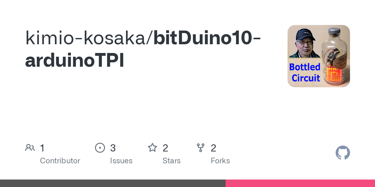

DrAzzy:
Where did you find a hardware package to support the t10?
Not to put words in @wilykat's mouth, but I want to make sure you get an answer since I'm certain it's of interest to you, I'm guessing it's here:
