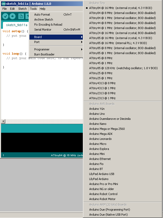

Yes , i can confirm that Google Code Archive - Long-term storage for Google Code Project Hosting. working fine with 1.6.0 IDE. Only one thing must be changed :
In Arduino\sketchbook\hardware\tiny\avr\platform.txt originally stated :
Default "compiler.path" is correct, change only if you want to overidde the initial value
#compiler.path={ide.path}/tools/avr/bin/..
And that must be changed to :
compiler.path={runtime.ide.path}/hardware/tools/avr/bin/
We can also override compiler flags for Attiny only if we wish, that it's great feature.
P.S.
And just discovered that EEPROM folder must be copied from :
Arduino\arduino-1.6.0\hardware\arduino\avr\libraries\
to :
Arduino\sketchbook\hardware\tiny\avr\libraries\
I change platform.txt, board.txt and add some libraries ( EEPROM - copied from \avr\libraries) for arduino-tiny originall lib. and add some option to change gcc optimisation flags from IDE directly :
Uploading and Burn Bootloader ( change fuse settings ) works fine from IDE.
This is the boards i include
Only ATtiny85 is modified - you can change others in board.txt - if you do that new one must be like modified one because there is some changes in in new IDE 1.6.0 board.txt options for example no more bootloader.path option just :
bootloader.file=empty/empty85at1.hex
and some others.
Just extract in sketchbook/hardware folder. This is for Arduino IDE 1.6.0 only. Has no effect on 1.0.x version ( they work as did before update )
