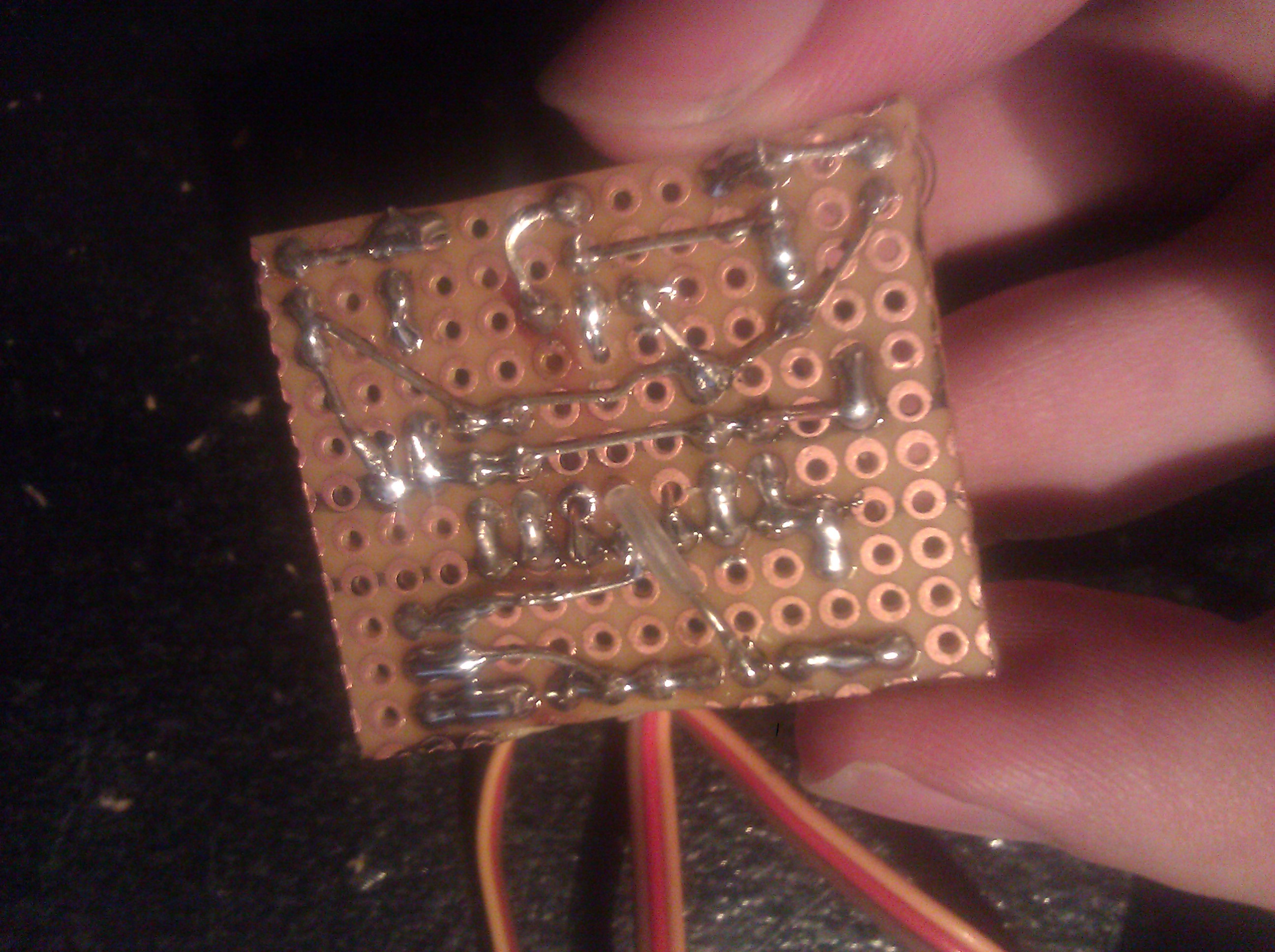

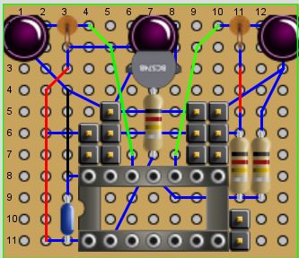

Similar to Pololu - Sample Project: Simple Hexapod Walker only with my own perfboard circuit and sensor design.
