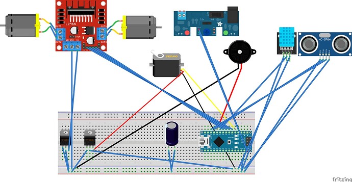

Trying to write a unique obstacle avoiding car
I am writing a Arduino script for my Obstacle avoiding Car... It should scan the area for obstacles using both ultrasonics and DHT11 (by calculating speed of sound) to avoid hitting it and go anywhere else, and if there are obstacles everywhere, it should trigger a buzzer with a frequency of 70mHz every 3 seconds for 1 second...
  1. I can't get the motors working
  2. the Ultrasonic seems to be detecting everywhere as obstacle
  3. the Servo rotates 360" not 180" for some reason (which broke my servo. After struggling to move/rotate, the top gear got broken...)

Then it is not a servo. Sometimes these are called continuous rotational servos, but they can not be set to a position only a speed of rotation.
That physical layout diagram is a bit useless as it doesn't show where to power is coming from to drive the motors from the long obsolete L296. And the bunch of blue wires coming from the L296 board, converging into a single point, and then going to some pins on what I presume is an rip off Arduino Nano clone, is a new low in clarity.
meagHz? even 70kHz is above the hearing range of most humans (~20kHz)

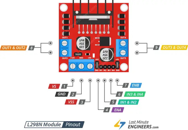

is the an enable pin that either needs to be jumpered on the motor board or diven with a PWM output
you may need to wait for the aoustic wave to dissipate between measurements, otherwize it detects the echo(s) from the previous pings
obviously you need to replace the servo (or just the gear).
but in general you should individually test each of these components and gaining an understanding, integrate them together
you seemed to have written a lot of code (or downloaded it). a common practice is to start simple, test each new feature and add features one at a time. Start with moving at a slow speed using a PWM signal to drive the Enable pin
the algorith for your robot is not obvious from looking at the code. why is StopMiving() called at the end of loop()?
i don't understand the notion of allBlocked(). Surely the robot can be turned 180deg and continue to move
another thing to bear in mind is that by detecting an object from farther away may only require a relatively minor (e.g. 15 deg) direction change to avoid
also, each function should have a well defined purpose. i don't understand why your measureDistance() is doing anything other than return the distance. why is it looking at temperature/humidity, that should be a separate function
I got the idea of Humidity&temp from Ultrasonic Sensor HC-SR04 and Arduino - Complete Guide which makes sense (at least for me) it is measuring distance between the car and the obstacle using both Ultrasonic and humidity sensors...
It returns a boolean when there is any obstacle detected...
It is already enabled with a jumper
sorry I mistyped this part... but it seems to be very high during testing
I will take that into action
it is a FS90 Servo but it seems to be broken...
i will try recreating that diagram
That does not mean that it is not a continuous rotation "servo"
you might find this useful
(working with a robotics student where we can use this

i think something is wrong with my Hardware Installation... it is still not moving (the DC Motors)

do you have the jumpers on the ENA and ENB pins
consider adding something like the following (some what edited to exercise the different parts of your code. Add an autoFlag to en/disable your existing code
no i removed them in order to use the pins for speed control

which arduino pins did you connect to them? and where in your code do you control the speed?
Pins 11 and 12 (this one specifically seems to be wrong because of PWM)

There is still no update of your schematic. It seems your capacitor is connected reversed...
The white side should have minus marks and should be connected to gnd...
If you keep using fritzy:
Use black for gnd, red for 5V.
Different colors for signals...
Place the components in such a way that you minimize the wire crossings.
