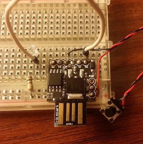

I'm trying to figure out how to make an if/then statement react to a button press on an digispark attiny85, and don't know what I'm doing wrong.
Why will the following code not do what I want?
I have LED and a resistor from P0 to 5v and a button from 5v to P3 (A3 input).
Thanks!

But, it didn't work. Now, after 5seconds of boot/wait, the LED comes on. The button does nothing, even if I tie it to gnd instead of 5v. I've attached a pic of the setup, just in case I'm missing some detail.
Yep. You seem to have connected the button between 5V and the input pin. That way it will always read HIGH, you need to connect it between the input pin and ground.
That suggests that the pin you are looking at is still floating.

I just programmed a tiny85 and your code (I cleaned it up a bit) works:
#define LEDPin 0  // pin 0 --> LED --> 330ohm --> gnd
#define buttonPin 4  // pin 4 --> button --> gnd
// I used pin 4 instead of 3 so I could put the switch right on the breadboard for clarity
  pinMode(buttonPin, INPUT_PULLUP);
  pinMode(LEDPin, OUTPUT);
  boolean buttonState = digitalRead(buttonPin);
  digitalWrite(LEDPin, buttonState);
If it doesn't, then perhaps your "digispark" is broken?
Note that you MUST use INPUT_PULLUP if you wire it this way:
Thank you!
Your code worked, so I looked at mine again. Calling out pin 3 as "A3" is what was crippling my sketch!
