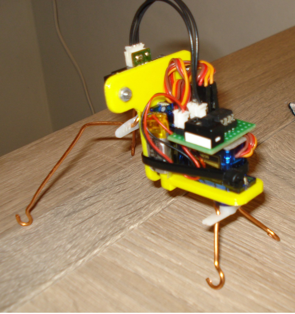

I have a problem with my ATtiny85 I can not load programs where two servos worry

This is my programmer with Arduino Uno, my PCB and my source code
I do not know which is the good library for the ATtiny85 , can you help me please

What I seek is 2servo on an ATtiny85 and works as an insect, should be able to sweep both servos
I looked everywhere but do not find what works
Can you help me please
