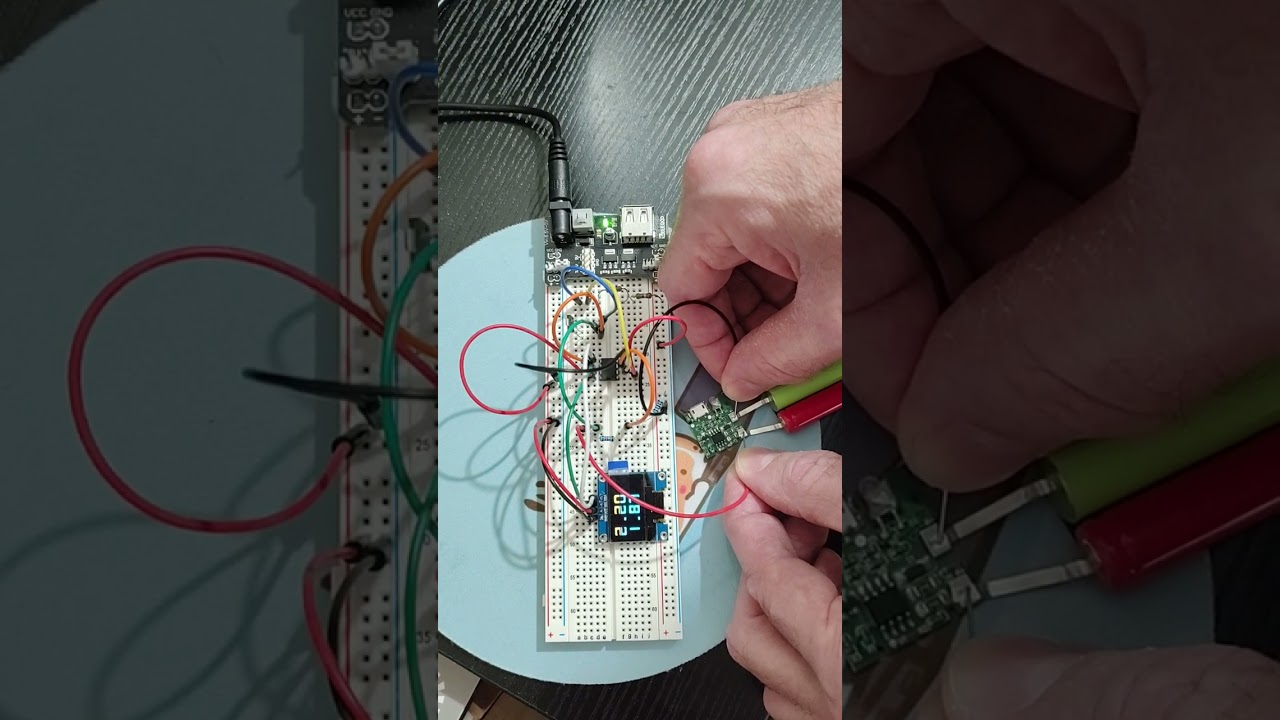

Hello,
I try to copy this project:
But something I connected wrong because it is not measure, and the screen refresh is too slow.
Here is a video:
I cannot found what I made wrong.
The programming I downloaded from the original video description. I didn't change anything just uploaded to the Attiny85 with Arduino Nano.
This is why I think it could be a connection issue.
Any ideas what could be wrong?

I burn the bootloader again on my Attiny85.
After upload the code again, and now it start to work but something is still wrong.

Attiny85, resistor 1 ohm 2 pieces, resistor 10K ohm 2 pieces, 3055L /I don't know what is this/, oled

  • You need to measure the voltage at pin 3 of the ATtiny85 with a multimeter.
    (do you have one?)
  • You then need to download the sketch again.
    (I recommend saving it this time - it might come in useful).
  • Modify the sketch by adjusting 'FACTOR'.
  • Reprogram the ATtiny85 with the modified sketch.
  • Test to see if the results are acceptable.
  • If still not correct make further adjustments to 'FACTOR' and re-program etc.
We will help you further if you get stuck, but we would need to see the sketch to do so.
First of all thank you so much for helping.
Yes, I have a multimeter.
How much voltage is good on pin 3 ?
  • That measurement needs to be taken whilst a battery is being tested. Measure the battery voltage with your multimeter as well.
The voltage at pin 3 of the ATtiny85 should be half of the battery voltage, (it may be slightly different due to tolerances in the values of R2 and R3).
