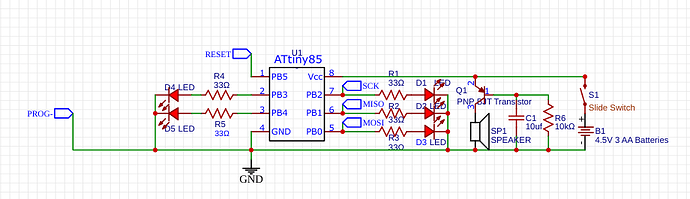

I have successfully programmed an Attiny85 to produce multiple channels of audio (Horray!).
Although it's only 2, and I need help with the third. For some reason PB2 is not toggled, and PB3 & PB4 just over-lap on PB1 & PB0 and create an awful sound.
I don't know if it has something to do with the code "PORTB ^= PBx", I'm not sure if this is the correct way to toggle pins. Since PB0 & PB1 are the only ones working properly, maybe I'm switching between pins 0 & 1, instead of toggling them?
