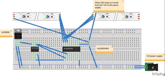

Hey guys,
New to the forums/arduino/EE, but having a blast!
Currently I am trying to control two RGB LED strips with an ATTiny85 microcontroller that I programmed with an Arduino Uno. The program I have basically fades the two LED strips between blue and white.

This works perfectly fine while hooked up to the Arduino and a breadboard. It also works perfectly fine with a single 4-leg RGB LED with the ATTiny85 with the previous code loaded on it.
Everything seems to fall apart when I try to control the two LED strips with the ATTiny85 and a ULN2803APG. The strips light up, and they do a bit of quick color flickering, but it doesn't fade out and are quite bright. This may be because the LED strips are getting power directly from the +12V power source.
As I'm new to this I assume there is quite a big problem with my circuit. Can anyone please take a look at my circuit and point me in to the right direction? It is attached.
Thanks so much!
