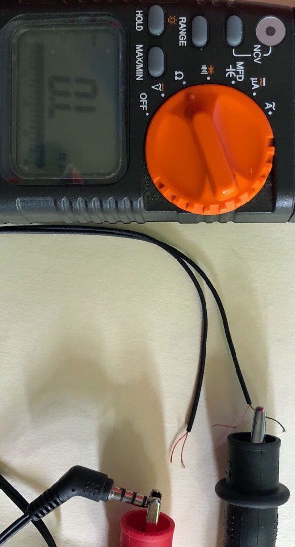

I need a Audio 3.5mm cable for a power sensor and I opened up this cable and found 4 "wires".
I found a post where it says there can be 2 or more but wires. Mine look more like threaded shielding.
Will I be able to use this in my CT current sensor?
I'm actually trying to identify the cables with the rings on the connector with a continuity test with a multimeter but i can't get any of the four wires to show continuity on any of the rings. Why?

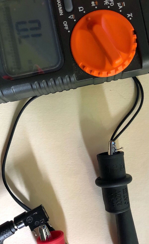

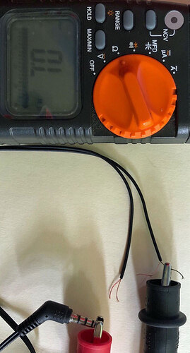

I tested two things:
A. Multimeter leads to cut peeled wires of the connect end of the cable
B. Multimeter leads to a 3.5mm jack pins
But there is no continuity beep and there is always OL ohms, so I must be doing something wrong.
A broken cable isn't unheard-of, but ALL of the connections shouldn't be broken.
I wonder if it's that "funny" enamel-coated (insulated) wire? Try measuring a short-distance on one of those shield wires to see if the meter probes are making contact with the copper.
If that's the case, you can scrape-off the enamel but you usually end-up breaking some of the strands and it's still very-difficult to solder. So, you might want to try a different cable or buy a plug and make your own cable.
You have a TRRS plug (4-conductors) but the your jack appears to be 3-conductors. Or, you could have 2 ground connections on the jack, or maybe I'm seeing it wrong. They should work together but of course you won't get all of the connections.
It's not unusual for the microphone and headphone wires to have separate shields. But, there should be 3 signal-wires plus the shield(s).
The shields should be connected together at the connector(s). The colors aren't helpful (before you test/measure) because nobody cares about the colors inside the cable (unless you bought a single-ended cable that came with specs.)

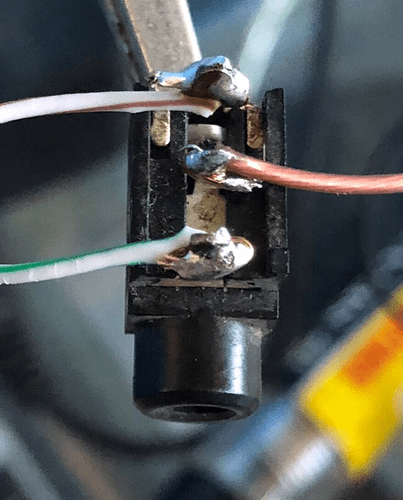

ok so i have a TRS female connector and Im gonna wire the cables to it. The connector has 3 leads, do I need a wire to each lead?
That depends on what your power sensor needs. A CT is two wires, but you might want to ground
the screen at the Arduino end only to reduce noise pickup.
OK not the best soldering job but it'll have to do for now:
