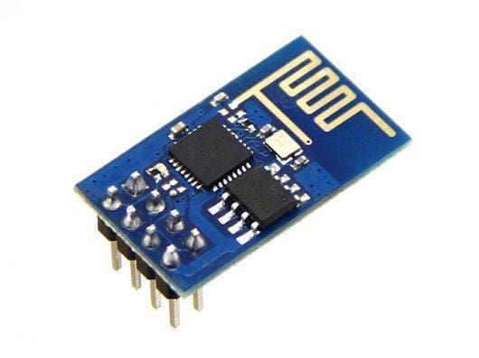

Would this module be ok for the wifi?
There are lots of variety and I'm not entirely sure what the differences are!
https://www.coolcomponents.co.uk/en/wifi-serial-transceiver-module-w-esp8266.html
Looking to extend this project with a temperature and humidity sensor too, is this an ok sensor board? Seems a bit expensive https://www.coolcomponents.co.uk/en/humidity-and-temperature-sensor-breakout-si7021.html
If your route is using the DFPlayer then you won't need an Arduino. You can just buy a Wemos D1 or a Nodemcu. Those boards have the ESP8266 chips on board. You can program them in the same way you program an Arduino.
