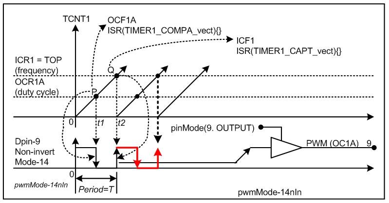

Let us try to understand the meanings of the symbolic names COM1A0, COM1A1, and OC1A with the help of an example: (The meanings of other symbolic names will be similar.)
Assume that we wish to generate the following PWM signal (Fig-1, say: 20 kHz) at DPin-9 using TCNT1/TC1 (Timer/Counter 1).
Figure-1:
1. The symbolic name of the PWM signal is OC1A (Output Compare Pin Channel-A of TC1) which is always available on DPin-9. There is now way that this PWM signal can be routed to any other DPin.
2. The signal is non-inverting which means that DPin-9 is intially at HIGH state. This is determined by the COM1A1 bit (Compare Output Mode Bit-1 for Channel-A of TC1) and COM1A0 bit of TCCR1A Register (Fig-2).

4. The frequency of the PWM signal is given below (for derivation, see data sheets); where, the frequency is detrmined by 16-bit ICR1 (Input Capture Register of TC1) Register and the duty cycle is determined by OCR1A (Output Compare Register of TC1 for Channel-A).
f = clkSYS/(N x (1 + ICR1))
where:
f = 20 000 Hz
clkSYS = 16 000 000 Hz
N = TC1 Clock Prescaler/Divider (1, 8, 64, 256, 1024)
ICR1 = 799 with N = 1
5. For 50% duty cycle, take --
OCR1A = 400 //half of (1 + ICR1)
6. Now, start TC1/TCN1 with the help of CS12 (Clock Selection Bit-2 for TC1) = 0, CS11 = 0, and CS10 = 1 (001 = 1 = N) of TCCRB register.

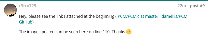

Hey, please see the link I attached at the beginning ( PCM/PCM.c at master · damellis/PCM · GitHub)
The image i posted can be seen here on line 110. Thanks :slight_smile:
Hi can you not see it? I tried to attach it...
the code is on line 110. Apologies I may have pasted it incorrectly. It did say 'this link has already been posted, are you sure you want to post it again'.
did it work this time?
