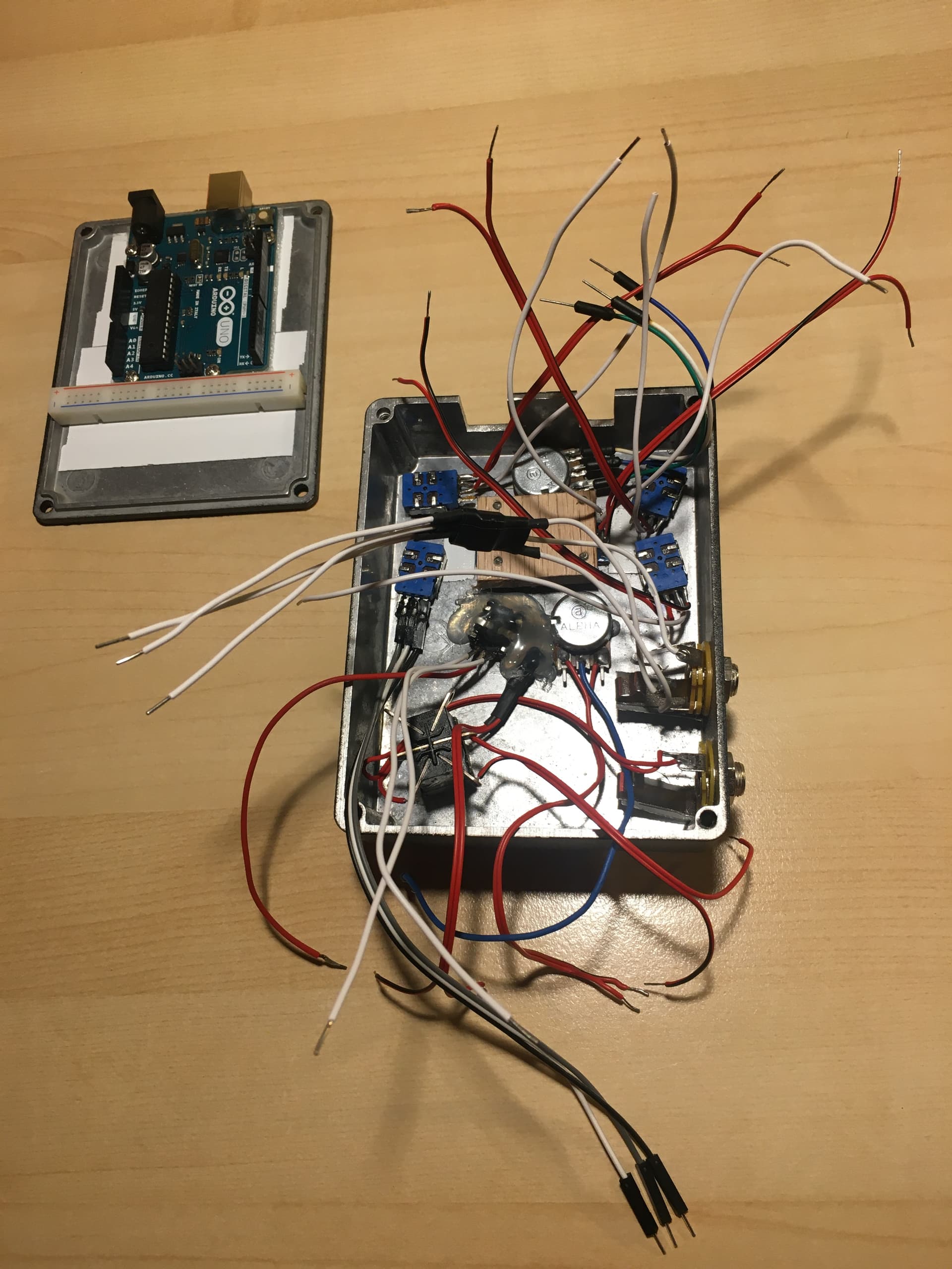

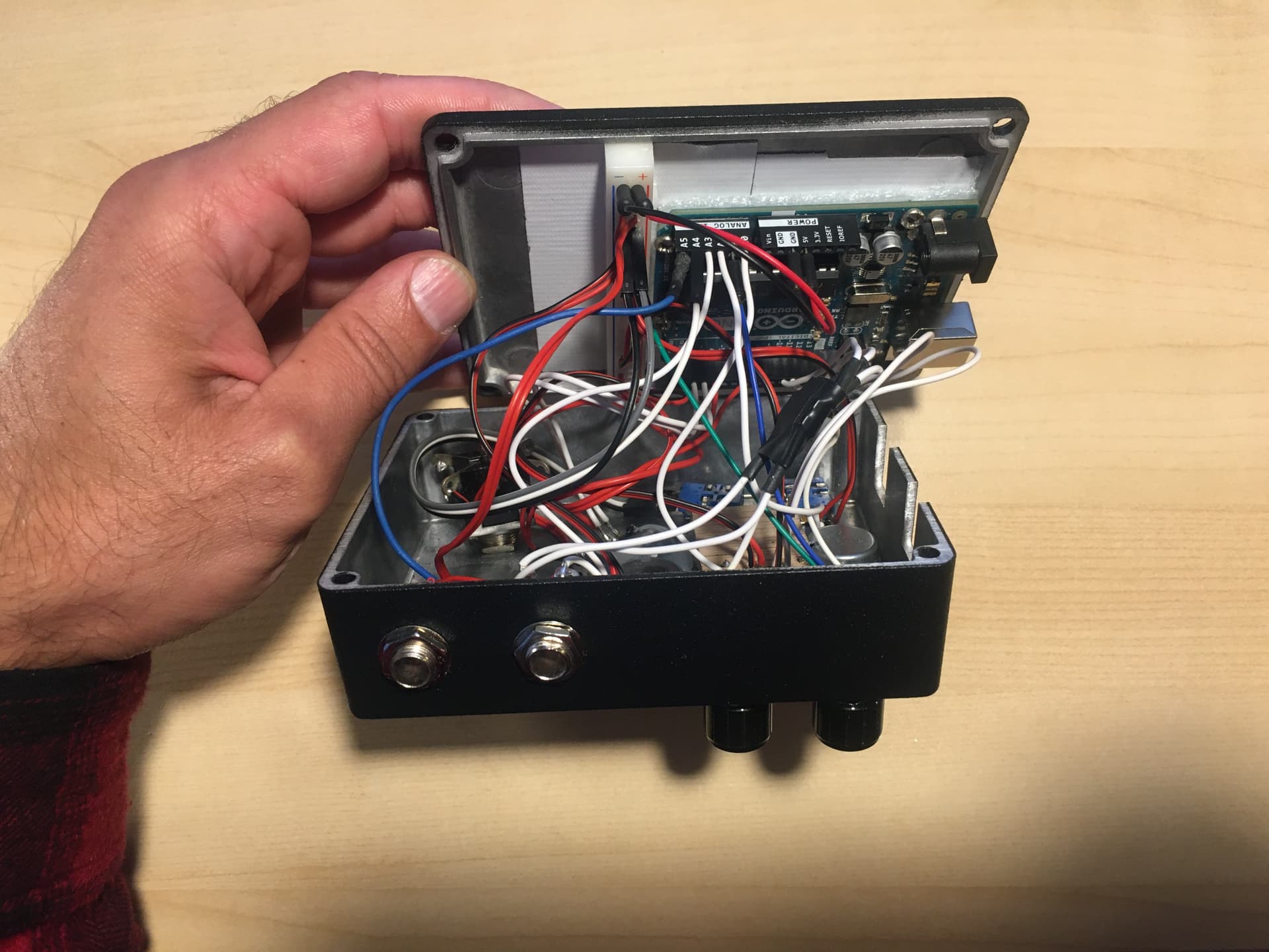

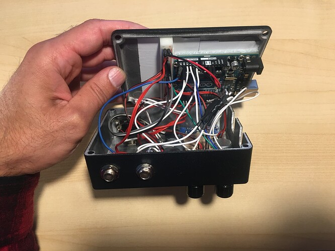

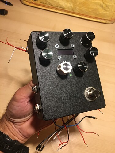

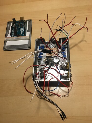

A quick update on this: It's going really well. I figured out how to control the digital potentiometer to give the correct signal to my effect pedal. I even like the visual appearance of the whole thing.
However, I am running into a problem now that is unrelated to the digital potentiometer and which has just to do with using 6 analog potentiometers at the Arduino Uno's 6 analog inputs. But, since it is unrelated, I have opened another topic for it: Six potentiometers and a display = arduino crashes
