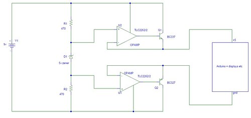

Power Supply Board
For the power, I didn’t want to add an additional power connection to the pedal, and wanted to tap into the existing 9v supply the pedal uses. I tried powering the Arduino and the other added components several different ways, of which all resulted in extreme noise on the guitar’s audio signal when it passed through the pedal. Allan (referenced above) helped greatly with this, and designed this power supply for me:
And here it is, worked up on the 2nd prototype board for installation inside the pedal’s enclosure:
Essentially, this power supply steps the voltage down from 9v to 5v, by shifting the positive side by 2v and also shifting the negative side by 2v, landing at 5v but keeping it centered around the 9v supply. Doing it this way completely eliminated the noise on the guitar signal, and allowed me to tap into the existing 9v supply inside the pedal.
Here is a look at the power supply laid out on a breadboard, just because it makes it easier to see how everything is connected. I did add a 100uf capacitor to the design (based on recommendation from Allan) to further protect against noise on the power bus.
Since the TLC2262/2 opamp is dual channel, only one is needed here. One channel is used for the positive side and the 2nd channel is used for the negative/ground side.

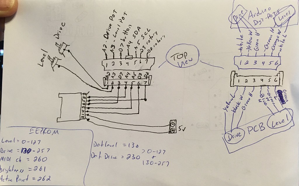

EDIT: I came across my header pin connector pin-outs, so thought I would share these as well
The left side is a 7 pin connector, bridging from the Arduino to the RJ45 and the wiper leads of the analog POTs. Notice I put the SDA signal on a twisted pair of the Cat6 cable by itself, as I had read somewhere to not mix it with clock or power signals.
On the right is a 6 pin connector, bridging the Digi-POT outputs with the pedal's OEM PCB (ie: where the analog POTs used to be connected).
The bottom left just outlines where values are being stored in EEPROM

Anyway, with your write up, I was able to adapt this for 6 Digipots and got it working on a PedalPCB Arachnid I built:
Thanks for doing the preliminary and paving the way! high five
To anyone it might help, I should mention that the power supply in the original post did not work for my 6 pots. Instead I used a simple, Chinese step down module.
Thanks, again!
Great job man! Looks like my code ported nicely to your setup 8) Right down to the "above" and "below" value indicators. So glad you were able to leverage what I did and make it work!
The Helix line is really, really good ... The HX Stomp would be a great centerpiece of a full board. I bought my Helix Floor on Reverb for $1050 used, then sold so many pedals, I actually made a couple hundred dollars in the end LOL.
I've thought about selling the Tech21 pedal, but it was such a labor of love, I just can't bring myself to do it ....
Interesting the power supply didn't work. It must be due to the reference points. Maybe the pedal you're working from has a different design than the Tech21 pedal has.
haha good to know about the Helix line! I may switch one day since I'm digging IRs and easy transportation haha
Yeah, I'm pretty sure it's because my circuit uses 3 or 4 pots as voltage dividers (3.3v) for the controls. Probably didn't like the power supply? shrugs haha
