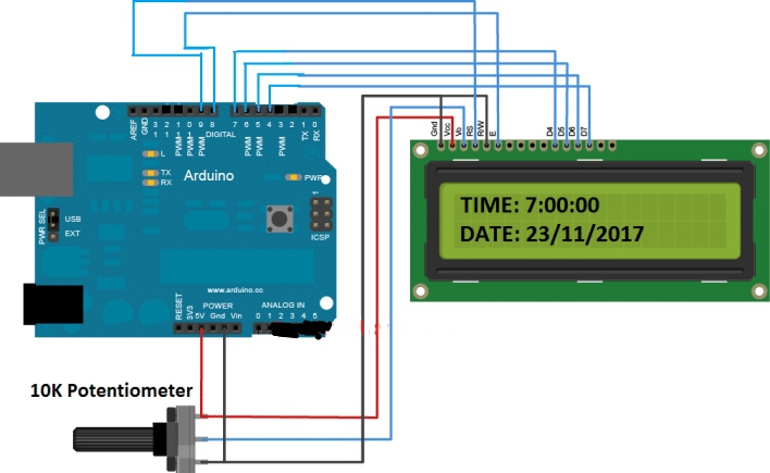

The relay coil is being energized automatically as soon as the AC bell is being connected to power source.I have connected a 1N4007 diode across the relay still the problem is same...Moreover the 16×2 LCD board and arduino uno board is malfunctioning as soon as the AC bell is being energized.please help

The bell i am using is 240V AC bell...so is there any possibility to somehow stop the back emf..I have used a diode 1N4007 across the relay but still it's of no use..can the relay be replaced by a TRIAC???

What is the actual 9V supply?
Can you post the data for the relay (coil current)?
The 4.7K resistor on the base of the transistor is way to high. 180 to 220 Ohms would better allow the transistor to saturate. Are you sure of the transistor pin out?
I see no diode across the relay coil. 1N4007 should be fine.

OP's images. How to post images.
I have connected the diode in reverse biased across the relay not shown in the schematic.If not through Arduino power pins how should I power up the RTC module???
In the diagram, the RTC is powered by A2 and A3. Not the power (+5 and ground) pins.
I have assigned them as power pins in my programme.A2 and A3 as power pins
How much current does that relay coil require? BC548 is only rated 100 mA and it will need a much smaller base resistor to get that, something like 470 - 680 Ohms.
Does the circuit work without power to the bell?
Yes the circuit works perfectly when the bell is not powered.But as soon as the bell is triggered the circuit is malfunctioning.Is the diode 1N4007 connected properly in the schematic???When the bell is not powered the circuit perfectly triggers the relay but as soon as the bell is connected it is malfunctioning again
