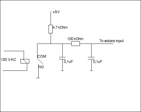

I want to detect power failures in a greenhouse. So I came up with this simple idea. I bought a relay and it's connected to the 120V AC power source. When there is a power failure, the relay will close the circuit and I want to detect it with one of the ARDUINO inputs. So I copied a simple circuit with a switch and a pull-down resistor. Instead of the switch, I connect the relay Normally Closed wires. This is working fine, sometimes(!), but then I loose Serial communication and if I add a LCD for example on the ARDUINO, garbage will display and the ARDUINO in general starts to do weird things after I switch the relay on/off a couple of times.
Now nothing is connected on that relay, so I guess the coil is causing some noise. Any simple ways to resolve that? Attached is my first fritzing diagram. This is actually my first post ever!

The relay are not correct connected, use COM and NO connections instead.
Try to filtering the signal with this circuit.
You also have to invert the signal in your code.

Hard to say what the exact problem is, but you might be better served with an AC input opto-coupler like this one.
You need to have a capacitor (something like 0.1µF 440VAC working) in series with this also with a 1k resistor.
And it is safer and more reliable (may even be a significant part of the present problem) to have the switch/ relay/ optocoupler or whatever between the input and ground, not between input and Vcc.
A simple snubber circuit as Paul__B suggests should work great, and/or you could use an MOV.
I've used 130VAC rated MOVs with success and typically use this on 120VAC circuits. Don't confuse the 185V rating - this is DC.
Also, increasing the distance between the relay and Arduino would decrease (but not eliminate) any interference. Sheilding is another option to consider.

Thanks everyone, I tried a few of your suggestions with the material I had on hand. They made me realize that, maybe the relay just by being too close to the ARDUINO could cause interferences. I unplugged it from the board and just connecting/disconnecting it from the power source would cause the LCD display to start printing garbage. The closer to the board, the more I get garbage. Since my computer is connected on the same power bar and it is used to power the ARDUINO, maybe the interference comes from there. That garbage doesn't seem to affect the board, as the serial communication still take place and everything else works fine. So I reconnected it to try Pelle's circuit and it helps, but I still get the board to freeze from time to time, but a lot less often. All this made me try to use a shielded wire. So I took a shielded sound cable, and solder the shield to ground. Now the board doesn't freeze anymore. I'm just not sure if I should connect the other end of the shield to the ground of the electric line?

Its recommended to have a snubber on an AC relay coil to reduce arcing and noise, Your pullup resistor should be lower,
perhaps 470 ohms to reduce noise sensitivity and add 10nF to ground on the Arduino pin to further reduce sensitivity.

You sure of what you are saying? In this case, the relay contact is the actual thing connected to the input pin; it has nowhere near enough voltage on it to spark!
