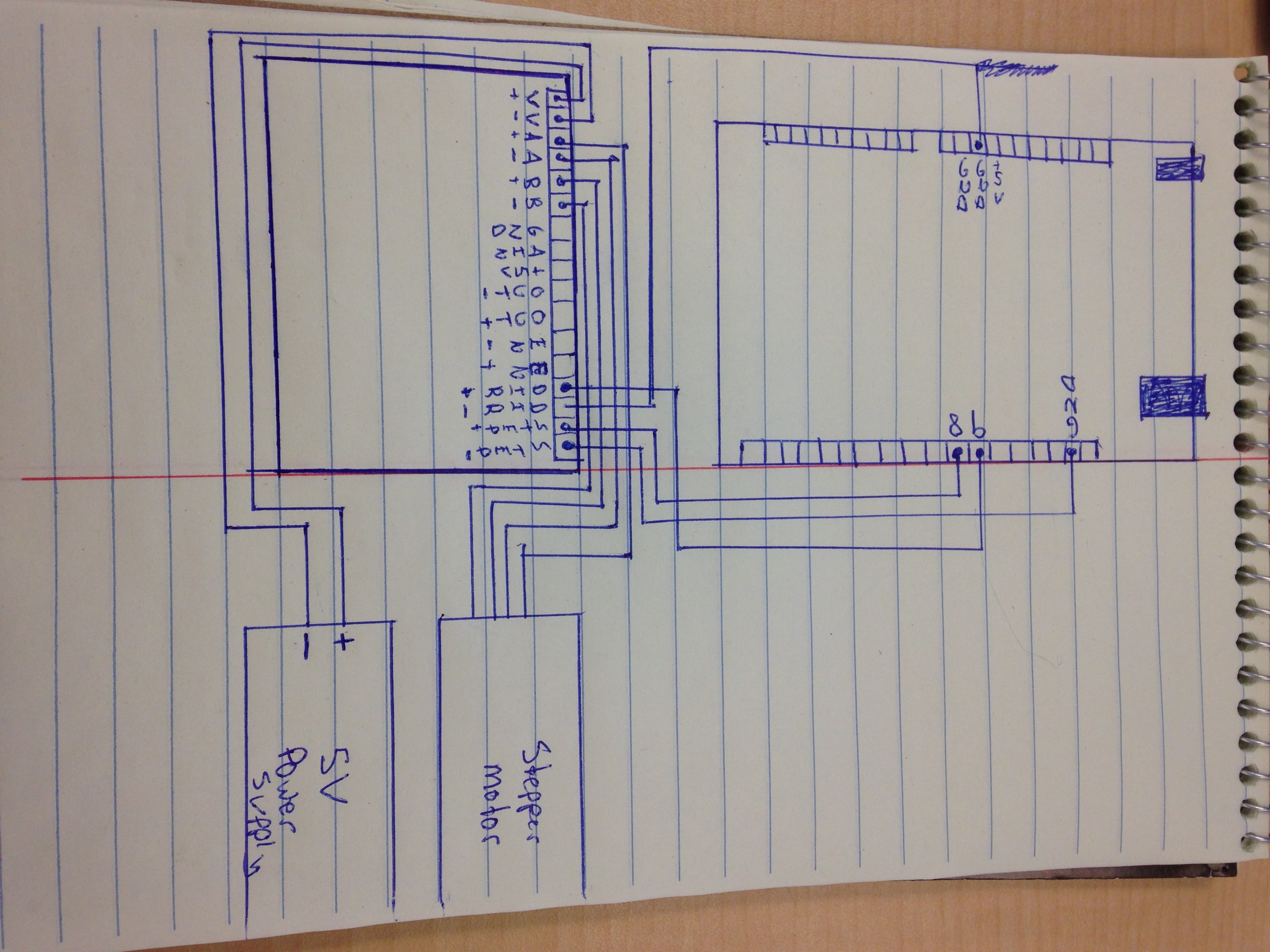

I have read and downloaded the manual a while back. I was able to control the motor using the drive and the computer software, but I am unable to do anything other than give a single command as the computer software only allows for one command at a time rather than writing script. I would like to be able to use the Arduino to write a script and have the motor oscillate back and forth to allow a linear slide constant back and forth motion. I have the motor connected to the drive and the power supply connected as well. What I need to do is figure out how to wire the motor drive to the Arduino and write the code. I know that I need to use the STEP+, STEP-, DIR+, and DIR- to create bidirectional motion and I do not believe that I need the EN+ and EN- terminals as I do not think I need to use the enable function, but I could be wrong.
I am having trouble because I do not know how to wire this motor drive to the Aruduino and I do not know what code to use. I have tried many different wiring schematics and different codes but noting has helped.

The problem is that there is not real detailed page that shows how to wire to a micro-processor. I would say that the best pages in the manual to look at would be 2-7 through 2-9.
Thanks. I can see that page.
Now, what is it about that page that you need help with?
Maybe the best thing would be for you to make a pencil diagram showing how you think everything should be connected and then post a photo of the drawing.
As I said in Reply #2, I think all that is needed is to connect Step+ to an Arduino I/O pin and Step- to Arduino GND and the same for the DIR connections.

I have attached a wiring diagram. The code I tried to use was the one that you had sent earlier in the thread:
http://forum.arduino.cc/index.php?topic=277692.0
This wiring or code is not working for me. I know I must be doing something wrong, I just do not know what. Any help would be appreciated.
Full page photo.pdf (426 KB)
You have a breadboard in that drawing. Please re-draw the circuit without any breadboard so we can understand it properly.
Also, please post the picture a a JPG file so we don't have to download it to view it. See Image Guide
And please post the code that you are trying copied from your Arduino IDE rather than from my link - just in case there is an important difference.

Below is the code and I redrew the wiring diagram.

Image from Reply #18 - I already gave you the Image Guide so I would not have to do this.
