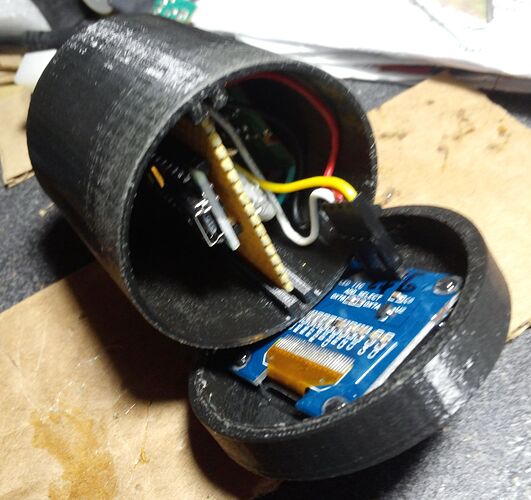

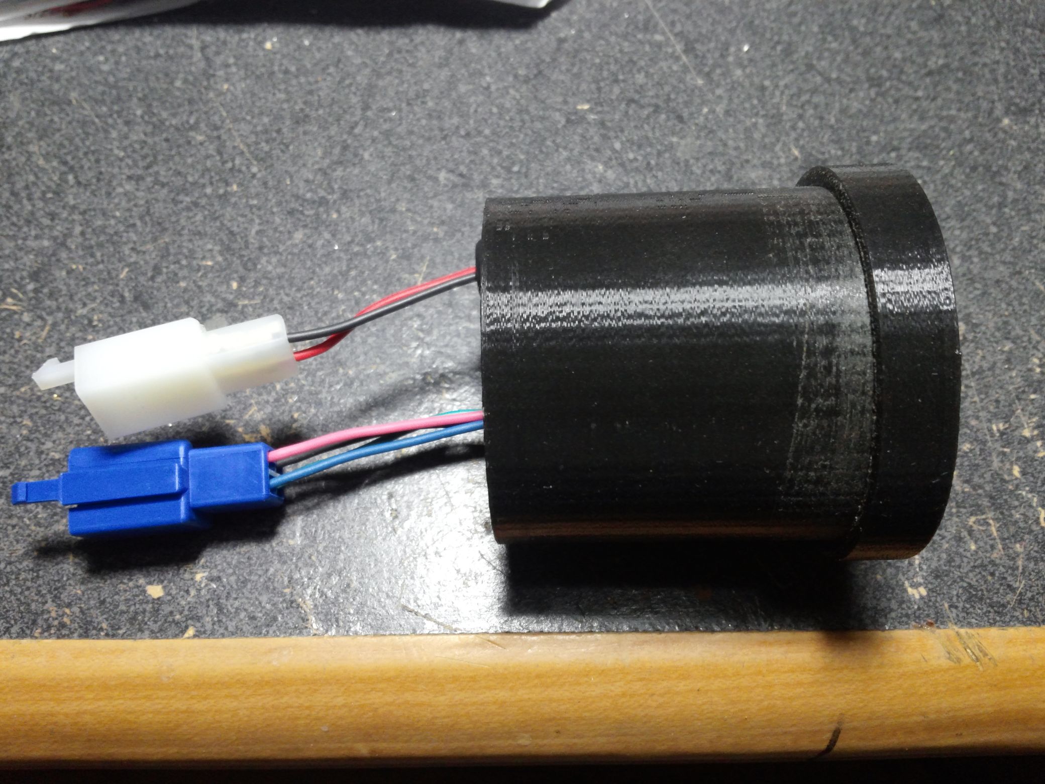

Thanks to help in various sections of the forum, I’ve completed my automotive combination oil temperature and air temperature/humidity gauge. It was made using commonly available parts except for the housing, see below for zip file. It has bench tested OK, I cannot test it in the car right now since it is inoperable. If I can find this thread again after the car is operational, I’ll report back how it is doing.
While this particular gauge is used for oil temperature and air temp/humidity, it could of course be used for many other functions via a modified sketch.
The gauge will measure oil temperature from a range of like -40 F to +300 F via a common GM sensor.
It will measure air temperature, humidity, and heat index via a common DHT22 sensor.

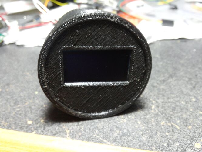

All of this will display on a common low-cost OLED. The display alternates each reading every few seconds. Timing can be adjusted via the delay after each function.
The board can be reprogrammed by removing it from the car, then removing the cap/bezel and plugging it in via USB.
The housing is a press-fit into 52mm openings, although a u-bracket could be used to make a standard mounting.
Here’s an overview:
Concept/history
The Nano is small enough to fit inside a 52mm gauge housing. It can be mounted on some perfboard that will itself mount inside a slot built into the housing. The bezel/cap for the housing mounts the OLED. The gauge is about 2.25" deep overall, with 1.875" being the housing behind the bezel/cap. The Nano has an added advantage as it outputs +5V that is needed for the GM sensor. I had looked at a smaller board (Teensy LC), but there were issues using the SH1106 library with it and it only output 3.3V, which did not work for my sensor.

Wiring runs through the back of the gauge and consists of a +12V and ground feed on a 2-pin connector, then a 4-pin sensor feed.
Sensors were mounted in the engine bay/front fender using some shielded cable.

I have attached some pics of the completed project and a zip file for the gauge housing and cap. They are in .stl format so they can be used for 3D printing. They may require some minor work to align the OLED.
