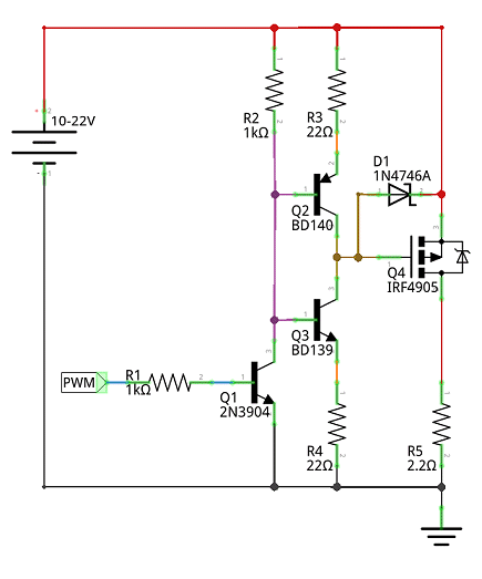

Here's my latest take on this:
Description:
  • Power supply is now 10-22V. This reflects the power management that will be used.
  • PWM is available only after the 10-22V is available (the Arduino is powered by a DC-DC switching regulator which gets its power from the same 10-22V).
  • I've switched to using the BD140/BD139 transistors as they can carry up to 1.5A (plus I have a few on-hand). I've selected R3 and R4 so they carry a max of 1A at 22V.
  • With the BD140/139 pair, I've calculated (hopefully close to correctly) their base current requirements to be at least 33mA. This means that they cannot be reasonably driven directly from the Arduino, hence the inclusion of the 2N3904 to drive them.
  • The 1N4746A is there to ensure the IRF4905's gate never sees more than about 18V.
    Comments, suggestions, et al are very welcome.
Cheers!
Dirk
dephwyggl:
There's way too much power dissipation in that zener when running at 22V. The peak power is over 3 Watts, it will cook. Those little zeners are good for about 1W, but they run really hot at that. For reliable operation try to keep it down about half a watt.
You've basically got three choices.
  1. Use a big 5W zener and waste a bit of power there (it will still get HOT).
  2. Use a much larger driving resistance (currently 22 ohms) and get the worst case zener power down well under a watt. This will slow your edges down, but not enough to really cause a loss problem, given the relatively low switching frequency. Actually it might be a good thing as far as EMI/RFI is concerned.
  3. Rethink your powers supply arrangement.
I don't see why you want to persist with the Q2/Q3 arrangement that allows shoot-through. Sure you've got the resistors there to limit the shoot-through, but why not just use the class-B (common emitter push-pull) stage as previously suggested. Then you only need the one current limiting gate drive resistor.
If you really want to do it with discrete components and want it as simple as possible I would have suggested something like the following.
BTW. You can increase that 15 ohm resistor quite a bit at the relative low switching speeds you're using. You may need to go up to about 150 ohms if you want to keep zener power under control now that you want to run it at 22 volts.
In case anyone is wondering about the diode in the above circuit. It simply replaces the pnp (pull down transistor) in the class-B push-pull output stage (diode A-K replaces the pnp E-B junction). You can do this because no further current gain is required for the pull down, as first stage (lower npn) driver can already sink 400 to 500 mA without any problems.
Actually you save almost nothing in terms of cost or component count by using the diode instead of say a bc327 pnp, they're both worth just a few cents in quantity (diode is 2 cents cheaper). I only do it because I can, and the axial diode is just easier to wire up, especially in a prototype or breadboard.
One final comment. The BD139/140 in your most recent circuit are completely unnecessary. At under 500 mA peak current, and that only for a microsecond or two every millisecond, the 3 cent bc337/327 can do it ridiculously easily.
stuart0:
Ouch. Two steps forward, one step back. :frowning: But, that's why we're here; extra eyes to spot silly missteps. :slight_smile:
I haven't finalized power management yet, but I'll certainly keep in mind that I'd like to see this part of the project without that zener (i.e. keep max voltage under 20). As mentioned, this is an automotive application and typical voltages will be more like 11-15 (most commonly around 14.5), but transients can occur and need to be managed.
stuart0:
  1. This doesn't strike me as a good solution.
  2. This is definitely worth considering. Some previous iterations used 2N3906/3904 pairs in the totem pole. These were set to drive the MOSFET at 100mA. Maybe more palatable for that poor, overworked zener. I'm starting to think that the trade-offs made to go to lower power BJTs may be worth it.
  3. Power management has not been finalized, but at the moment I'm anticipating using a bidirectional TVS rectifier to limit voltage, a cap to handle spikes, and a reversed p-channel IRF4905 to eliminate reverse polarity instances. (More on this in a separate topic once we're done here.)
stuart0:
Also regarding your previous circuit. While it's a big improvement on your earlier efforts (NOSUM has helped you a lot), I don't see why you want to persist with the Q2/Q3 arrangement that allows shoot-through. Sure you've got the resistors there to limit the shoot-through, but why not just use the class-B (common emitter push-pull) stage as previously suggested.
NOSUM certainly has helped. :slight_smile:
I'm all for simple, but I don't seem to be able to see how the basic requirement of the p-channel MOSFET being driven to OFF by default is accomplished (efficiently) except with a PNP on the "high" side of the totem pole. (Consider my latest circuit as though the Arduino doesn't exist, the MOSFET must be off, and minimal power is being consumed.) As far as I've been able to understand to this point, this totem pole arrangement is also rather more efficient than other discreet arrangements I've seen; the majority of power it consumes is during switching of the MOSFET (it consumes very little power during the MOSFET's actual on/off times). Yeah, there's some shoot-through, but I'm thinking this trade-off is worth it.
stuart0:
You can increase that 15 ohm resistor quite a bit at the relative low switching speeds you're using. You may need to go up to about 200 ohms if you want to keep zener power under control now that you want to run it at 22 volts.
We'll see about the 22V, but yeah, I'm starting to understand switching speeds a little better and driving the IRF4905 at more than 100mA may not be necessary.
stuart0:
I used these only because I have a few on-hand, and apparently I'm prone to way over-engineering everything. :stuck_out_tongue: I have lots of 2N3904/6s on-hand, too. I'll likely start with these and see where the MOSFET's temps get to. If too high, I also have some 2N5401s and 2N5551s (they could triple the drive current - again punishing the zener). I don't (yet) have any BC327s.
Thank you for all your comments, Stuart. Keep 'em coming; progress is occurring. :smiley:
Cheers!
Dirk
Further to this:
stuart0:
Would inserting a, say, 1k resistor just before or just after the zener work? Or would that still allow too much voltage at the MOSFET's gate?
dephwyggl:
Further to this:
Yes but you don't need to go that high, 150 ohms limits the power to about 0.5 Watts at the maximum 22 volt supply.
Ok, this is quite a different thing to the "Power supply is now 10-22V" that you said before. That COMPLETELY changes my assessment which was done for steady 22V operation.
Do you really expect 22 volt transients in a 12V automotive system to persist for the many seconds that it would take to burn out that zener? It isn't going to happen. If the 22V max is truly just for transients then the rating of the Zener that you're using is perfectly fine.
dephwyggl:
You don't seem to understand how a p-channel mosfet works. The truth is the precise opposite of what you've said above. Your most recent circuit turns the mosfet ON (see note*) when no input is connected.
Note*. Actually your circuit hardly works at all, with both Q2 and Q3 fighting each other, when the input is either low (as an output) or high impedance (as an input). That is as close as your circuit ever comes to turning on the mosfet however. You need to completely forget about that circuit.
THE P-CHANNEL MOSFET IS TURNED OFF WHEN THE GATE VOLTAGE IS HIGH (That is, when it's close to the source voltage, which is at the +ive supply voltage in this example).
The simple circuit that I posted (reply #32) however leaves the mosfet OFF when no input (or a high impedance) is supplied from the Arduino. So if you drive it with any pin that is not used by the bootloader then it will safely keep the mosfet off until your program chooses to initialize it as an output and start controlling it.
In my circuit:
  • High at the input gives mosfet on.
  • Low (or high impedance) at the input gives mosfet off.
Hi again.
I will try to deal with your comments / questions one at a time.
Keeping your FET turned off with nothing happening.
In order for this to happen, your Arduino must be in stasis (no output) and with its output low (ground).
In this condition Q4 is not conducting and R2 on the base of Q1 and Q2 keeps Q1 turned on providing a low impedance path to 12V for the gate of Q6 which keeps it turned off. If you really feel that you need extra security to keep your FET turned off you could place a large value resistor of 100K or so across the gate source connections.
It may be worth noting here that FET's are voltage driven devices unlike BJT's which are current driven.
Therefore when the gate does not have a varying voltage applied, it draws no current apart from the gate source leakage which will be in the low microamp region or less.
Power on settling time for you Arduino.
That is precisely what the delay circuit is for and will prevent the FET from being switched on until your Arduino has had time to boot and settle. If the delay as shown is to long then C2 can be reduced in value for a shorter period.
Transistors for the Totem pole.
I have had a quick look at the spec sheet for the 2n3904 /6 that you have been using. Their collector current capability is not up the task in hand and do not have enough gain. It is not mandatory that you use these devices. I have been using the BC327 / 337 combination for many years for this sort of thing and they work very well. You do not want devices with a lower current capability. I don't understand your reasoning there.
My comment about "The base emmiter junction of Q4 clamping the output of your Ardunio".
I shall attempt to explain:
The base emmiter junction of a BJT is analogous to a forward biased diode. It will turn on at approximately 0.6V (the precise voltage is dependent on many factors which I won't go into here). Before the conduction point is reached, the junction resistance is relatively high. When the b /e junction starts conducting, the dynamic impedance drops dramatically. This means that a further small increase in voltage will cause a much larger increase in current through the junction. The process is exponential.
Persisting with trying to increase the b / e voltage in this circumstance will inevitably lead to the destruction of the transistor.
So, the upshot of all this is that if just connect the O/P of your Arduino directly to the base of Q4 it will clamped to one diode drop (0.6V) above ground and draw lots of current which will do your Arduino no good at all.
Placing resistors R3 and R4 as shown in the schematic negates this scenario. Just using one resistor between the Arduino O/P and the base of Q4 is not good practice and is something that I never do.
As I said in an earlier post, when trying to switch FET's quickly, resistance is your enemy. Try to avoid using them in the gate drive circuit.
Hope you can get your head around that lot. If not then come back and I will try to illuminate.
NOSUM
Wow. I definitely have gotten myself into more hot water than I anticipated.
Stuart, NOSUM, thank you both; your time and efforts are very much appreciated.
It seems that I've been less than clear on some things, and also that I don't understand some basic electronics. So. Back to fundamentals.
This project's goal: It is my intent to be able to switch one or more PMOSFETs (which control various types of LEDs, halogens, incandescents) with an Arduino. The Arduino and the PMOSFETs derive power from the same source. The PMOSFETs must be OFF when power is applied. They must stay OFF when the Arduino has initialized. I'd like all this to occur as efficiently as possible (though a car's battery does have some reserve, I'm loathe to waste any of it).
My understanding of transistors: Both p-channel MOSFETs and PNP BJTs are ON when there is no current/voltage at their gate/base when in a circuit, and turn OFF when their gate/base is provided with (sufficient) current/voltage; n-channel MOSFETs and NPN BJTs behave exactly the opposite. (I understand the difference of using current vs voltage to "switch" them off/on.)
The above characteristics of p-channel/PNP transistors is why I (wanted to) use a PNP to turn the PMOSFET OFF by default. I was hoping that the inverted totem pole would get me a way to turn the PMOSFET ON by providing power simultaneously to ("turning on") a complimentary PNP/NPN pair - while staying aware that there's a brief moment during this process when the PNP and NPN are both ON at the same time.
I am also trying to take advantage of the fact that MOSFETs consume very little power at their gates when they are either ON or OFF; I'm trying to minimize power consumption by (reasonably) minimizing transition times.
Here is an abstracted schematic of how I thought this would work:
  • Ra/Rb/Sa stands for the Arduino
  • Sa stands for an Arduino's output pin
    Required behaviour:
  • When S1 is closed, Q4 must be OFF.
  • When S1 is closed and Sa is closed, Q4 should turn ON.
    Does this (in abstraction) work? What am I misunderstanding?
Cheers!
Dirk
