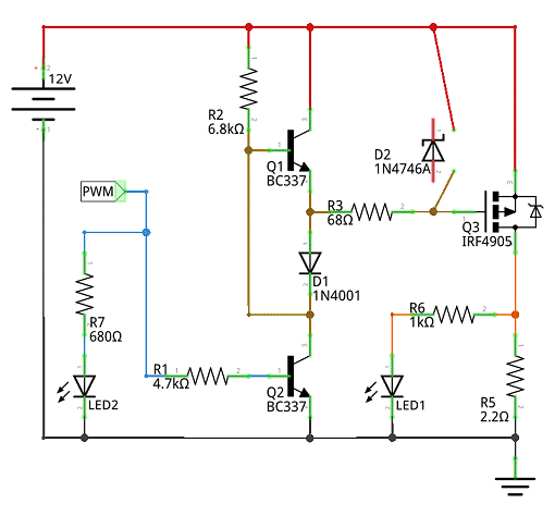

I'm in the process of finalizing some other stuff and when I reviewed the bits this topic contributes to my project, I noticed that it uses a "regular" diode (1N4001) at D1.
I now understand most of what this circuit does, but there was talk about specifically why a diode was used here instead of PNP BJT; I believe it was related to how a diode behaves, but cannot determine if this was specific to the type of diode.

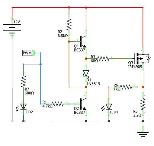

So, my question is: Is there any functional reason D1 can't be replaced by a Schottky (1N5819)? Like:
From what I've been able to figure out, the main differences between these two diodes is that the 1N5819 is faster in recovery and has a lower Vf. (I would tend to think that this would help here. ...but I've been wrong before. :confused: )

When Q2 is OFF, there will be no current flow through D1 or Q1.
So they will be OPEN, this leaves the gate of Q3 floating.
Not a good thing as Q3 will stay ON after Q2 has been ON and Turned Q3 ON.
In fact not sure why you have Q1 and not just a resistor to keep Q3 Gate at Q3 Source potential when Q2 is OFF.
D1 as a Schottky is OK.
Tom.... :slight_smile:
TomGeorge:
Um, are you sure? When Q2 is off, the current through R2 has nowhere to go but Q1's base, turning it on, which in turn provides power to Q3's gate, turning Q3 off.
I thought so. Thanks for your corroboration. Tom. :slight_smile:
Through Q2 base then where?

TomGeorge:
Hi,Through Q2 base then where?
Current at Q1's base "turns on" Q1, allowing current to flow via CE through R3 to Q3's gate. Are you saying there's not enough current there for Q3's gate?
Note: I've breadboarded this exactly as shown and it works.

You must have leakage somewhere to help your circuit, probably through Q1.

What's the problem?
As shown with Q2 off, Q1's b and c go to +ve , Q1's e and Q3's gate go to about 0.7v less, , and no current then flows.
Allan
allanhurst:
What's the problem?
Just to confirm, you're saying "and no current flows" through Q3 when Q1 is turned on. Correct? (That is the intent in this circuit; Q3 should be off when Q2 is off.)

Q3 gate has a large capacitance - several nF . Hence when Q2 goes from on to off, current flows through Q1 into the gate charging that capacitance until it's voltage reaches about 0.7v less than the +ve supply.
Q3 is then off.
Then the static state is as I said - no more current flows.
Allan

Q1 is what's called an emitter follower whereby the emitter follows whatever the base is doing with a differential of 0.5 to 0.7V depending on load. What happens with your circuit is that Q1 is turned on by R2 when the gate of Q3 is more negative by 0.7v or so than the 12V supply. Q2 then discharges the gate of Q3. When the gate source voltage is reduced to or below the Vbe of Q1, Q1 turns off. Q3 gate may then start to charge up again due to external influence. If this happens then the emitter of Q1 will be drawn down towards 0V which will then turn Q1 on again and will discharge the gate of Q3 again. OK?
