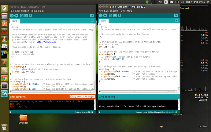

avr-g++: error trying to exec 'cc1plus': execvp: No such file or directory
my laptop run os ubuntu 14.04
i have normaly arduino IDE 1.0.5 install from apt-get
but now i try to use arduino id 1.6.0, i just download and extract and running arduino but i have error avr-g++: error trying to exec 'cc1plus': execvp: No such file or directory
if i have arduino ide 1.0.5 notting error message...what i must do?

A bunch of people have had IDE 1.6.x problems, including IDE crashes and bizarre compile errors, when they have an old 1.5.x installation. Those problems seem to be caused by out-of-date executables that the new IDE saves outside the IDE installation directory. In such cases it appears that the fix is to delete or rename the old "Arduino15" directory and re-install 1.6.x.
On Mac OS X:
/Users/username/Library/Arduino15
On Windows:
C:\Users\username\AppData\Roaming\Arduino15
I don't know where they hide the folder on Linux.

Linux = /home/.Arduino15
Just had this problem and found this thread. Using Debian and the location for the sub-dir is noted above. I renamed the directory, restarted the IDE as it will create a new /.Arduino15 directory and all should work.
