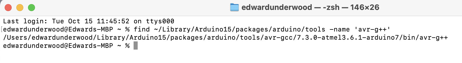

The programs that failed are part of the board's tools, not the IDE. But there may be some flags or magic bits that make the difference. Out of curiosity, you can try three commands in a Terminal
$ file `find ~/Library/Arduino15/packages/arduino/tools -name 'avr-g++'`

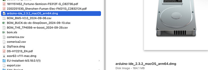

$ file "$(find /Applications/Arduino\ IDE.app -name 'Arduino IDE')"
/Applications/Arduino IDE.app/Contents/MacOS/Arduino IDE: Mach-O 64-bit executable x86_64
On an Intel Mac, they're x86_64. I wonder what you get when you install the board on Apple Silicon. After getting the right IDE going, you might try removing the board(s) and reinstalling.
So you know, your are dealing with someone who can turn the Mac on and use what I know. Not a technical person, you have been warned. Thank you for your reply. I have tried to run the terminal commands and posted 3 replies in order. I have an Intel based iMac and a MacBook Pro M.2 and I have 1.8.13 and 2.3.3 on both, yes I have the arm64 versions on the MacBook. I have no issues on the Intel iMac with either IDE and all the boards and libs. updated and work. I have a nano, UNO R3, Mega and now a UNO R4 WiFi and none of them work on the MacBook, they all work on the iMac.
The idea is to run the file command on the results of the find command, by surrounding the latter with backticks
which can handle multiple files, as in the case with cc1plus
$ file `find ~/Library/Arduino15/packages/arduino/tools -name 'cc1plus'`
or something fancier when there is a single file with spaces in its name
The results will be easier to see and use when posted as <CODE/>
In the meantime, you have two cc1plus, which is the program that was killed because of an "internal compiler error". One is for arm, but it is not the same version as the other one, which matches the (not-arm) avr-g++

edwardunderwood@Edwards-MBP ~ % find ~/Library/Arduino15/packages/arduino/tools -name 'avr-g++'
/Users/edwardunderwood/Library/Arduino15/packages/arduino/tools/avr-gcc/7.3.0-atmel3.6.1-arduino7/bin/avr-g++
edwardunderwood@Edwards-MBP ~ % file /Users/edwardunderwood/Library/Arduino15/packages/arduino/tools/avr-gcc/7.3.0-atmel3.6.1-arduino7/bin/avr-g++
/Users/edwardunderwood/Library/Arduino15/packages/arduino/tools/avr-gcc/7.3.0-atmel3.6.1-arduino7/bin/avr-g++: Mach-O 64-bit executable x86_64
edwardunderwood@Edwards-MBP ~ % find ~/Library/Arduino15/packages/arduino/tools -name 'cc1plus'
/Users/edwardunderwood/Library/Arduino15/packages/arduino/tools/avr-gcc/7.3.0-atmel3.6.1-arduino7/libexec/gcc/avr/7.3.0/cc1plus
/Users/edwardunderwood/Library/Arduino15/packages/arduino/tools/arm-none-eabi-gcc/7-2017q4/lib/gcc/arm-none-eabi/7.2.1/cc1plus
edwardunderwood@Edwards-MBP ~ % file /Users/edwardunderwood/Library/Arduino15/packages/arduino/tools/avr-gcc/7.3.0-atmel3.6.1-arduino7/libexec/gcc/avr/7.3.0/cc1plus
/Users/edwardunderwood/Library/Arduino15/packages/arduino/tools/avr-gcc/7.3.0-atmel3.6.1-arduino7/libexec/gcc/avr/7.3.0/cc1plus: Mach-O 64-bit executable x86_64
edwardunderwood@Edwards-MBP ~ % file /Users/edwardunderwood/Library/Arduino15/packages/arduino/tools/arm-none-eabi-gcc/7-2017q4/lib/gcc/arm-none-eabi/7.2.1/cc1plus
/Users/edwardunderwood/Library/Arduino15/packages/arduino/tools/arm-none-eabi-gcc/7-2017q4/lib/gcc/arm-none-eabi/7.2.1/cc1plus: Mach-O 64-bit executable x86_64
