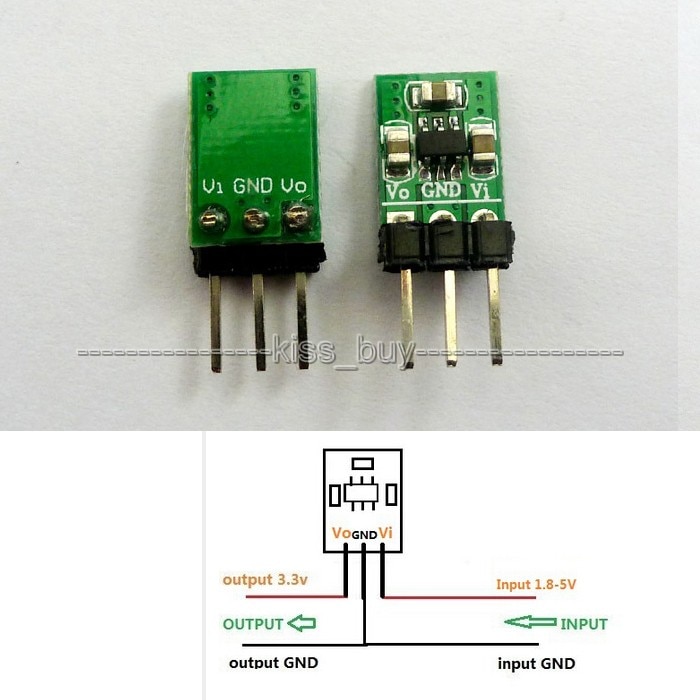

Other options are getting two of these and use them as daughter cards, one for 5v, one for 3.3v.
These are an option too:

I saw nothing that can be used as 'daughter board' above..
unless you meant through holes and the board stick straight up? (not really something I'm interested in doing then)
no links I saw had the 'half holes' (cant recall the official name) that can be soldered as SMD on -top- of the existing PCB design...
The specs (output) seem good though for what I'm looking for (enough current I believe)..

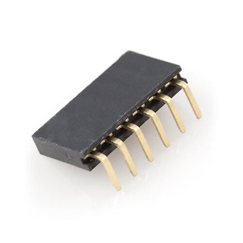

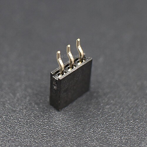

β€œ unless you meant through holes and the board stick straight up?”
There are right angled headers :wink:
And SMD headers:
BTW, you can mount things horizontally. :wink:

Talking about the last option you posted...
it looks as if there are only '3' components to it? Thats it?
Could I just incorporate those 3 components into my board?.. replacing the SMD +5v regulator I am currently using?
If supplied with more than +3v (according to the listing specs)..
"Input Voltage:>3V;output voltage 5V;current 380-480mA"
This should be enough current for my needs..
this could then power the current +3.3v regulator.. and I wouldnt need to worry about a '2nd' +5v regulator to power the MAX chip (or neopixels if I go that route, which is looking doubtful)
Or am I missing/overlooking something? Or not heeding to advice from above in some form?

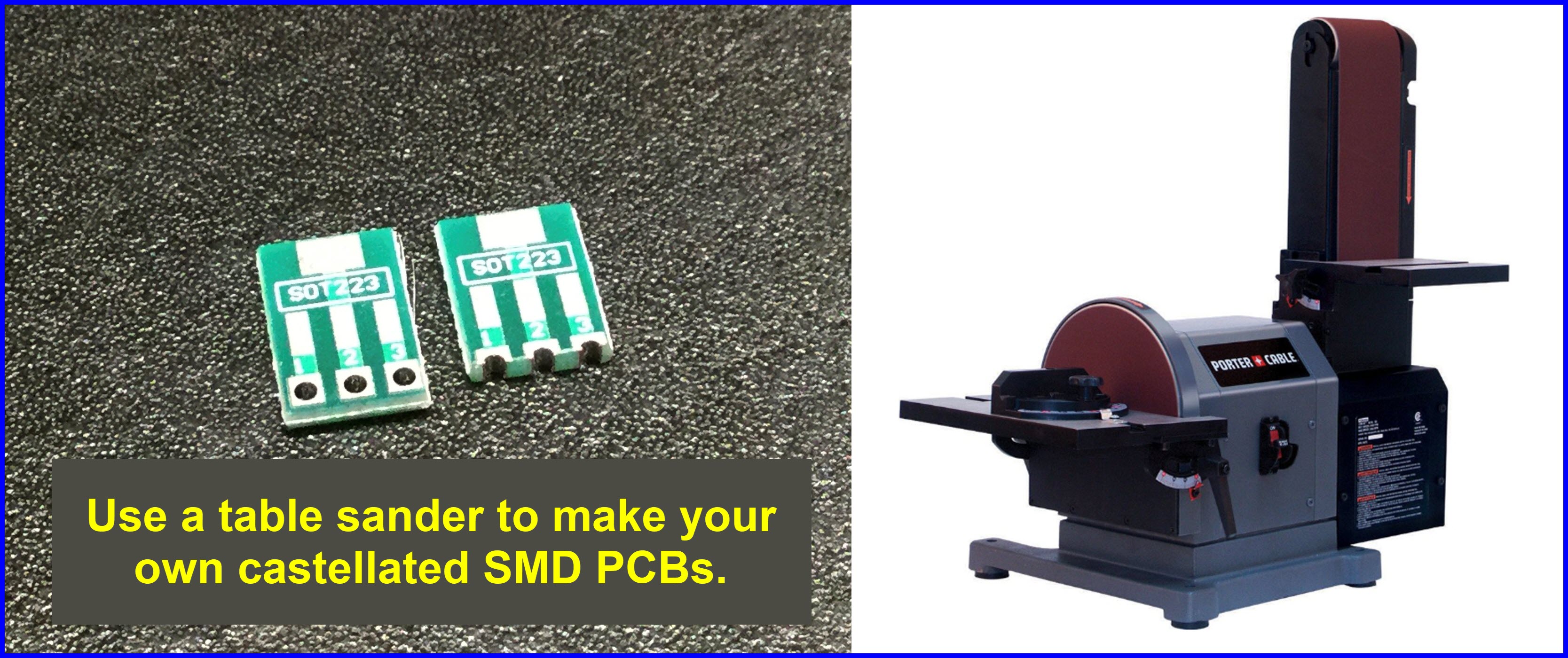

Make your own Castellated board by sanding off a Buck Converter's edge i.e. if it has a flat back.
Add Kapton tape on "Backside" :o

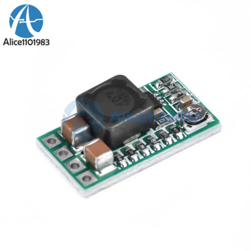

Anyways.. form the ebay link/auction..
I see these two as the +5v versions?
Questions for you pros: :)
  • Why are there '2' versions of a +5v board?
    ** (see attachment)
Looks like one board has:
'coil' (inductor?)
and a part that has:
"SS14" on it?
The other board:
2 x passive components
an IC that has:
218A
1549/50
on it?
I'd rather just get these tiny and few parts.. and follow suit? Anyone help on the parts they used? (or why one board/approach would be than the other?)
@larryd
I like the sander trick! I could use my mill too.. but the sander would be so much faster!
I'm gonna remember this the next time I'm going to 'daughter-board' one my pro-minis laying around (much better than using through hole headers all the time)
The visible coil version would be able to support more current.
Sanding the edges off works well.
Wow..
I didnt realize there were any components on the bottom!
Thanks for showing me.
500mA or so would be fine...
I'd actually prefer the other way.. but I'll give either way I try I guess? (first time/attempt for both)
