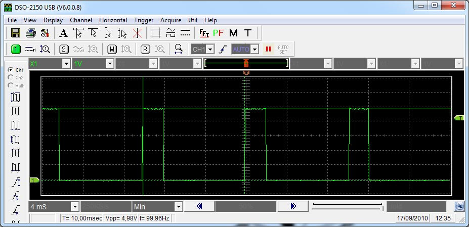

3 - Fixed timed loop
The main loop duration is critical for the filtering and PID modules
int STD_LOOP_TIME = 9;
int lastLoopTime = STD_LOOP_TIME;
int lastLoopUsefulTime = STD_LOOP_TIME;
unsigned long loopStartTime = 0;
void loop()  {
// your code ...
// *********************** loop timing control **************************
  lastLoopUsefulTime = millis()-loopStartTime;
  if(lastLoopUsefulTime<STD_LOOP_TIME)         delay(STD_LOOP_TIME-lastLoopUsefulTime);
  lastLoopTime = millis() - loopStartTime;
  loopStartTime = millis();
This loop runs 100 times per second (100 Hz)
Motor will receive an updated PWM value every 10 milliseconds
Loop timing is easily checked using a scope
just toggle one Digital Output within the loop:
an easier way: add serialOut_timing() in the loop and watch the serial monitor

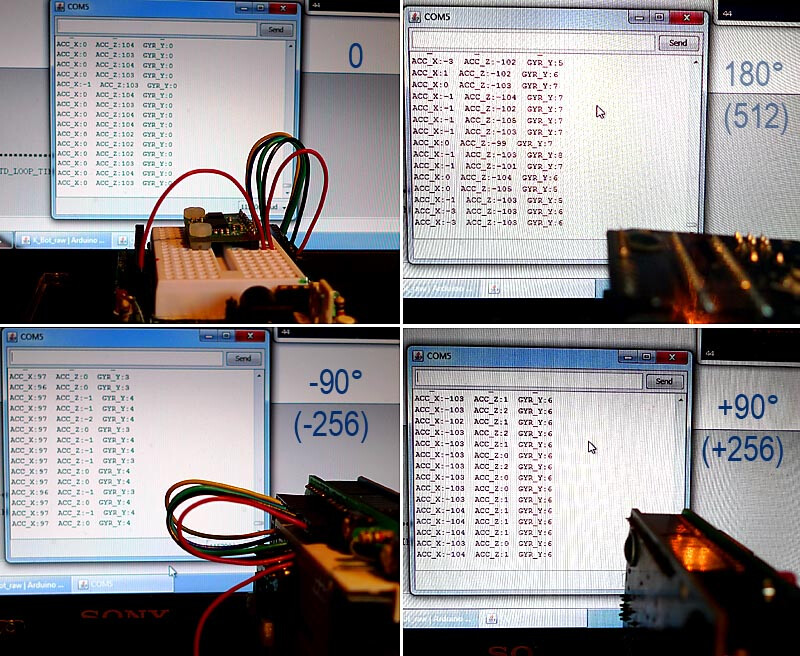

4 - Checking sensor data format
// Main module   K_bot               angles in Quids, 10 bit ADC  -------------
// 4 - Checking sensor data format    display raw sensors data
#include <math.h>
#define   GYR_Y                 0                              // Gyro Y (IMU pin #4)
#define   ACC_Z                 1                              // Acc  Z (IMU pin #7)
#define   ACC_X                 2                              // Acc  X (IMU pin #9)
int sensorValue[3]  = { 0, 0, 0};
int sensorZero[3]   = { 0, 0, 0};
  analogReference(EXTERNAL);                                   // Aref 3.3V
  delay(100);
  calibrateSensors();
// ********************* Sensor aquisition & filtering *******************
  updateSensors();
// ********************* print Debug info *************************************
  serialOut_raw();
void serialOut_raw() {
static int skip=0;
  if(skip++==40) {
    skip = 0;
    Serial.print("ACC_X:");           Serial.print(sensorValue[ACC_X]);
    Serial.print("  ACC_Z:");         Serial.print(sensorValue[ACC_Z]);
    Serial.print("  GYR_Y:");         Serial.println(sensorValue[GYR_Y]);
// Sensors Module  ---------------------------------------------------------------------
void calibrateSensors() {                                       // Set zero sensor values
  long v;
  for(int n=0; n<3; n++) {
    v = 0;
    for(int i=0; i<50; i++)       v += readSensor(n);
    sensorZero[n] = v/50;
  sensorZero[ACC_Z] -= 103;
void updateSensors() {                                         // data acquisition
  long v;
    v = 0;
    for(int i=0; i<5; i++)       v += readSensor(n);
    sensorValue[n] = v/5 - sensorZero[n];
int readSensor(int channel){
  return (analogRead(channel));
The sensors values vs position should read as follow:
Horizontal ( 0° = 0 Quid ) ACC_X: 0 ACC_Z: XX GYR_X: 0
Left side (-90° = -256 Quid) ACC_X: XX ACC_Z: 0 GYR_X: 0
Right side (+90° = +256 Quid) ACC_X:-XX ACC_Z: 0 GYR_X: 0
Reversed (180° = +512 Quid) ACC_X: 0 ACC_Z:-XX GYR_X: 0
For ADXL330/335, XX value is around 100:
Before going further, make sure you get that type of symetrical data
(this is one pitfall in this project ;))
It is now time to adjust sensorZero[ACC_Z] by adjusting "sensorZero[ACC_Z] -= 102"in order to have opposite/symetrical values (ie +103 and - 103) when going from 0 to 512 Quids (O° to 180°).

You can check the (noisy) Acc angle and Gyro rate within the serial monitor
a better option is to display graphical data using LabView or Processing
I can share my code with Labview owners
