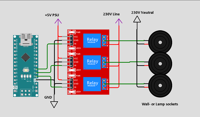

Conecting 24, or 36, output devices, a Mega sounds like a good choice. It has 54 input/output pins.
Know that the relay coils consume power, needs some current.
One suggestion is to use 12 volt relay modules recieving their power from a 12 volt power supply.
Connect all GND's and let the Mega control the modules.

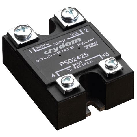

Sounds like a fun project. Take a look at solid state relays, they can be gotten with zero cross which will keep the power lines clean and can be driven directly from an Arduino. They are also quiet. Something like this picture. Try just one first with one of the lamps, they have a bias network on the AC side that may cause your LED lamp to glow. Relays will not have that problem.

an UNO can drive the requested 12 separate pins.
You mentioned you will place the lamps in a circle.
What logic do you have in mind to switch on/off each single lamp?
