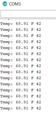

Works fine.
In answer to the questions posed in your comments, float(analogValue / 1024) returns zero because analogValue / 1024 will always be zero as both are integers and this operation is performed prior to casting. Either of the two values within the parentheses needs to be cast first as a float for the operation to work as desired. In this particular instance, placing a decimal point at the end of 1024 would have sufficed. Having done that, there would have been no need for the explicit cast. So the two immediate solutions would be,
temperature = float(analogValue) / 1024; //which you already employed, or
temperature = analogValue / 1024.;
The reason for this, which is also the answer to your second question, is that when performing a calculation the compiler/processor will set aside temporary storage, either in registers current unused or on the stack, for intermediate values. The amount and type of storage is determined by the largest type found in the values being used in the calculation. In your case (both first and second questions) analogValue and 1024 are both integers and thus storage space is allocated for an integer temporary value which, based on integer division, in this case will always be zero. In the first instance, this zero was then being cast as a float which would then simply become 0.0, and in the second case, passed into temperature, also as zero.
With respect to your printout, the value 42, which is analogValue, according to your first calculation float(analogValue) / 1024; equals 0.041.. then * 500 = 20.508. Presumably this is Celsius as then you convert temperature = temperature*1.8+32; to Fahrenheit which equals 68.91, exactly what is being printed. I fail to see where this is a problem.

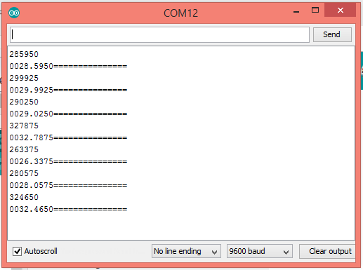

The following sketch provides temperature measurement value with 4-digit accuracy after the decimal point without float.
/*This sketch gives 4-digit accuracy after decimal point without float*/
unsigned long tempC;
byte bcdArray[8];
  analogReference(INTERNAL);
  tempC = (uint32_t)1075 * analogRead(A5);
  //Serial.println(tempC);
  for (int i = 0; i < 8; i++)
    byte x = tempC % 10;
    bcdArray[i] = x;
    tempC = tempC / 10; //0, 1, 2, 3, ..., x7
  for (int i = 7; i >= 4; i--)
    Serial.print(bcdArray[i]);
  Serial.print('.');
  for (int i = 3; i >= 0; i--)
  Serial.println("===============");
That statement is rubbish. An LM35 can not possibly detect the difference between 27.0456 and 27.0457 degrees Celcius, so it is pointless to construct a string that contains more than one decimal point or to claim that there is accuracy involved in the meaningless string.
But, please look at what is happening here:
tempC = 100*(1.1/1023)*analogRead(A5);
==> tempC = 0.107526881720analogRead(A5); ~= 0.1075analogRead(A5);
To retain the quantity 0.1075 (in order to make meaningful all the 4-digit after the decimal point), I would like to multiply tempC by 10000; as a result, I get:
amplifiedtempC = 1075*analogRead(A5);
While displaying the result, I divide the amplified value by 10000; I get 4-digit after the decimal point. Based on this analytical calculation, I have concluded that there is an accuracy of 4-digit after the decimal point.
If using float, am I allowed to execute this command : Serial.print(tempCFloat, 4); and then saying that I am presenting a temperature value with 4-digit accuracy? Or, should I say that the precision is 4-digit; but, the accuracy is 2-digit?
This is the screenshot of an LM35 based System.
Moreover, The data sheets says that the output voltage of LM35 changes linearly with temperature.
If this is the case, for a change of temperature from 20.00000C to 20.10750C, the output voltage will be changed from
0.200 V to 0.201075 V. In order to detect such a small change in voltage/temperature, we set the ADC's VREF at 1.1V instead of 5V.
You are assuming, incorrectly, that analogRead() will, with am LM35 sensor attached, return every possible value from 0 to 1023.
Thanks for all your help!
So the LM35 returns 1023/10?
Is that why I see the following output?
Temp: 68.91 F 42
Temp: 68.91 F 42
Temp: 68.91 F 42
Temp: 68.91 F 42
Temp: 68.91 F 42
Temp: 68.91 F 42
Temp: 68.91 F 42
Temp: 68.91 F 42
Temp: 68.91 F 42
Temp: 68.91 F 42
Temp: 68.91 F 42
Temp: 68.91 F 42
Temp: 68.91 F 42
Temp: 68.91 F 42
Also, I have a Osepp Uno R3 Plus (Osepp Starter Kit 201)
