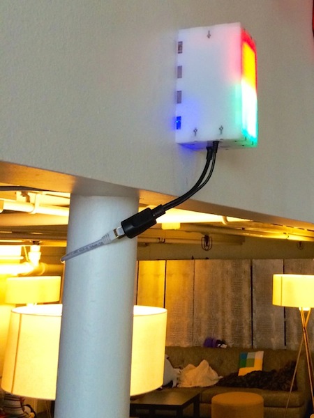

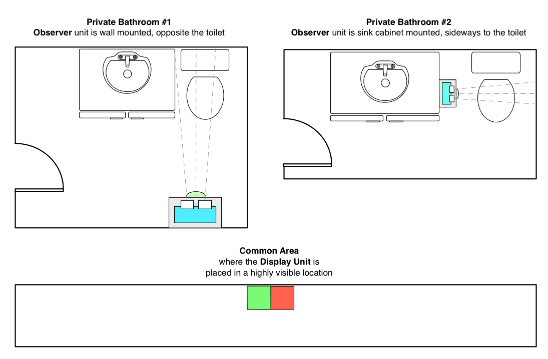

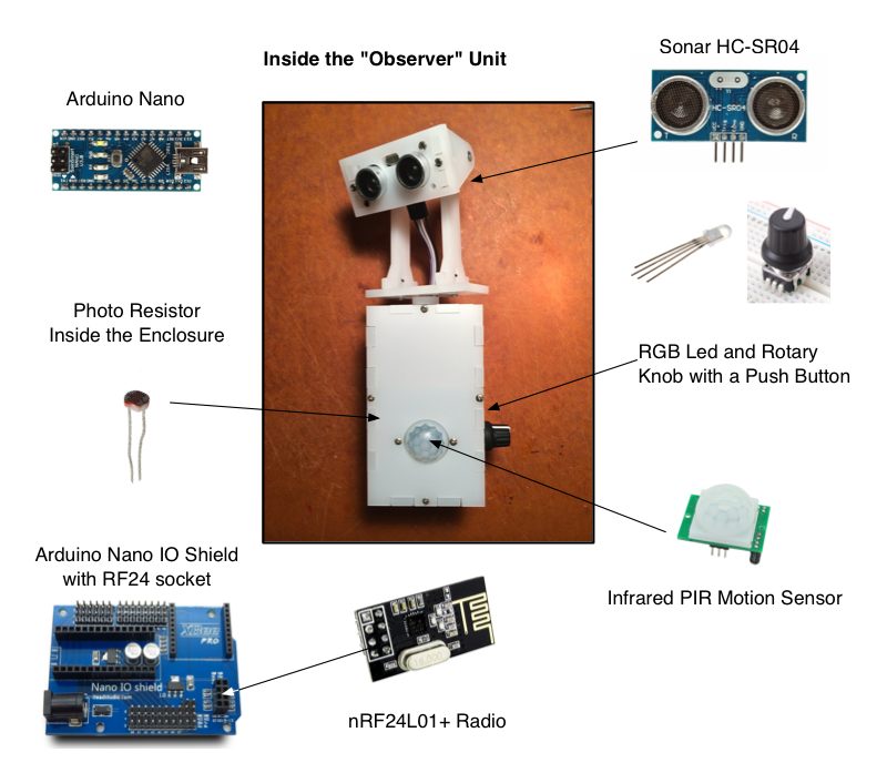

Given my foray into Arduino over the last few months, I knew I could come up with a solution. I got approved for a small budget of about $200, and started looking around.
The problem was very simple: people needed to know when each bathroom was occupied, or not. Just like on an airplane you can see bathroom light on/off, I wanted something similar for our two bathrooms. Something everyone could see.
Read the full story on the blog post here:
Download software, box designs, libraries here:

I'd have gone with some kind of switch in the door lock, so when it's locked, you know someone's in there from a light coming on. (Just like on an aeroplane, where you can see the toilets' occupancy status from your seat.)
Door lock switch would have been the simplest solution, if it were possible, but it's a rented building and we have no authority to change door locks, especially with something that's connected to electricity :slight_smile:
So think of this solution is when you can't touch the doors :slight_smile:
