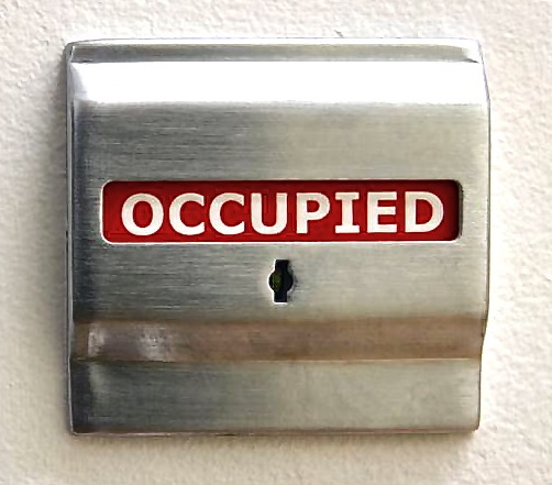

well, there was one......
I see the question asks for the simplest sensor.....
do we only discuss sensors ? he did not ask about what to do after sensing.
and although the only sensor actually offered was not the simplest, it was electronical in nature.
although not inexpensive, this is actually simpler, IMHO, because it does not require any exterior wiring.
also, it appears we have jumped to the assumption (rightly so) that since he posted on an Arduino forum, he would like to have some electronical devices.
Yory, can you offer more details of what you want ? a simple light that goes on and off with a sensor like Crossroads posted would require wire, a power source and some indicators such as an LED,
I can see that one might want to connect to an Arduiono or something and find our from a distance what the status was.
