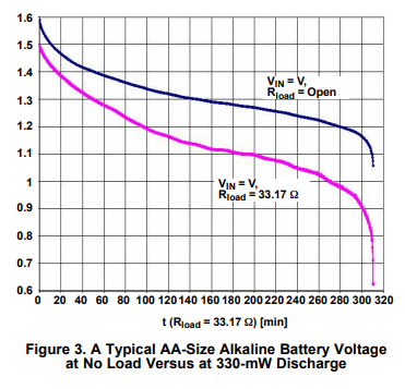

Now that we know you're using alkaline batteries, they have a discharge characteristic something like this:
Source: https://www.ti.com/lit/an/slva194/slva194.pdf
So you should be able to get something a bit better than just, "nearly dead" ...
What is the minimum voltage your MCU can operate at safely?
That, + about 50mV should be your "low batt" warning level.

The datasheet of the board's processor will tell you the minimum voltage for the clock speed used. By low batt warning, I mean the voltage at which the batts must be replaced or charged before errors or data loss occurs.
You got it, also the board needs a fixed ADC reference voltage below the minimum voltage level.
