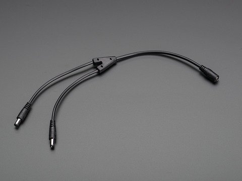

Even if I made the circuit, how would I connect it to my battery? THe battery is connected to the power jack in the arduino. Would I use a splitter(if such athing exists)? Please pardon my noob language.

http://www.adafruit.com/images/970x728/1351-00.jpg
That link return 403 FORBIDDEN error: I believe you must be logged in to see it.

I believe that he mean this one
