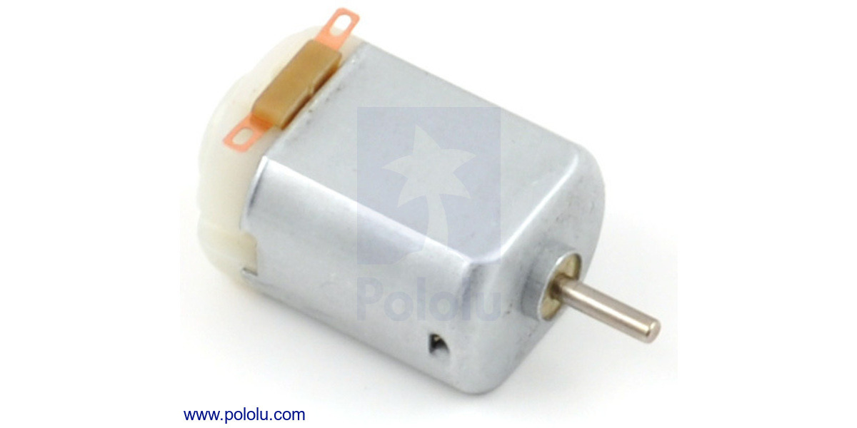

I think I know the Tamiya gearbox and motors that you are using. Very common. I have the same. But I just ordered these:
They are Tamiya motors also, and fit in the gearbox. Advantageously they use twice the voltage (6v) at half the current. They are also very cheap at $1.79 us each. 70mA free running and 800mA stall
