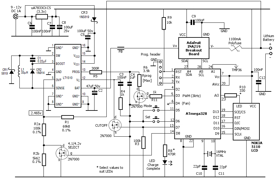

So you don't believe the 15 mV "jump" is the result of the battery current reducing to zero when the voltage drop across the two series batteries equals the op amp output and the difference of potential reduces to zero ? Or that one of the two batteries
is charged and stops conducting current causing the other to float ?

I have some mosfets and LT1215 op amps and some small caps and other components. I could try to combine your LOAD box integrator with the OP's cartoon . I don't have any current shunts at home but there's an electronic surplus store in Sunnyvale, called Halted Specialties that has lots of stuff. (I'm in Los Gatos, CA,USA)

That being said, any current controlled design that charges a battery (presumably NiMh) using an arduino and doesn't have the 15 mV oscillation when the battery is fully charged, would meet the design criteria specified. Since the OP's design is incomplete, the missing part would have to be "filled in" .(all the part numbers, values (like the shunt resistance value) , specs, (such as the Setpoint) , voltages etc, including components not shown (like the integrating error amp)) and last but not least the code.
Since it doesn't look like anyone else is going to do it I completed the design, made a schematic , wrote the code, tested it, collected the data and took a screenshot of the scope monitoring the mosfet gate drive signal.
Now the post is complete and can be reproduced and replicated by anyone because it contains a "real" schematic (with component values) , data, code, and scope screenshot.
The circuit does , however , assume the op amp Subtractor exists to monitor voltage of the charging battery and control dac output accordingly. Attached code does not include that because I did not have the battery voltage monitor circuit at the time. I will update the software when I add that.
NOTE: There is an anomoly/"bug" with the current measurement code. I am attempting to "debug" this issue. Feel free to comment out that code in the mean time. The "bug" is that only the FIRST current measurement value printed is correct. All subsequent values are way off. I don't know what the cause is yet. S/W is not really my area of expertise so I may have done something stupid.
ALSO, I am currently adding the relay to the schematic. The code has already been updated to include the relay so the schematic is "lagging" the code at the moment. Sorry about that.
