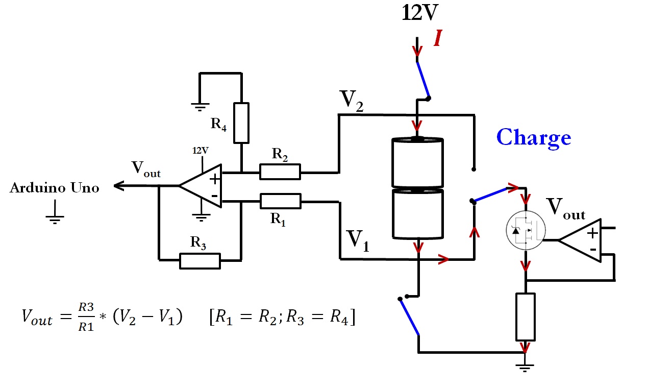

Hello Everybody,
In the past I often found a solution here so now I try with something I could not solve with google.

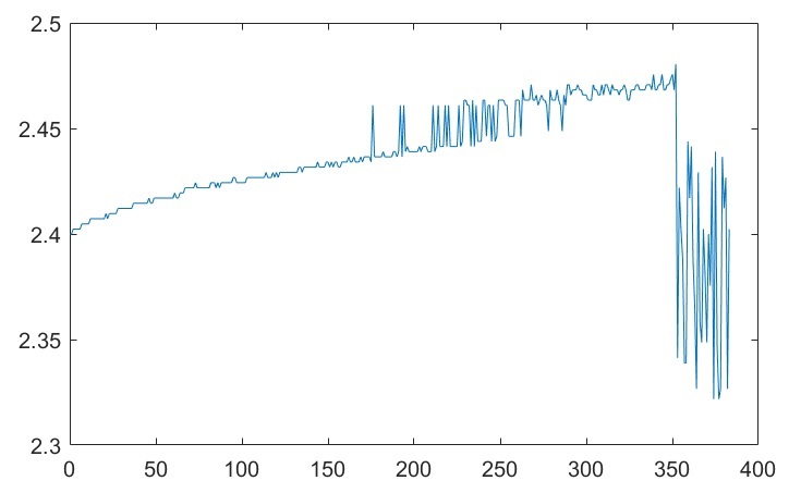

I build a little current controlled battery simulator to charge and discharge cells with different current profiles. For this I have a cell, the charging/discharging circuit and the cell voltage measurement. I use an OP Amp with the output voltage directly connected to an ADC port of an Arduino Uno. The OP Amp has two functions: 1. multiplying the cell voltage times two (better resolution) 2. giving me just the cell voltage since for the charging the negative pole has not the same potential as ground. (see attached circuit figure)
The Arduino gets its reference voltage from an external precision reference (5V.) As you can see in the "test" figure, the measurements works well (precise enough, not noisy) except for one point:
When hitting about 2.44V the measurement starts to jump weirdly as if the resolution has decreased a lot. Does anybody has an idea why this could happen?
I already tried to measure precisely 2.5V with the result of an output voltage of 5V at the OP AMP and 2.49something as Arduino output. I have a bit of the feeling that it could be the Arduino, but not a slightly hint where to start looking.
In the past I, let’s say, mistreated the analogue input at least once with overvoltage but couldn’t determine any changes in the measurement quality afterwards. Could the route for my error could be somewhere there?
Thank you very much in advance! I hope somebody had something like this before.
Best regards
Karsten

As mentioned, the voltage plotted that looks wierd is actually the battery reaching the charged state at 1.4 V (OP's output voltage is about 1.75 times the battery voltage.)
The battery is alternating between charging and discharging at the charged voltage. (probably a few hundred mV)

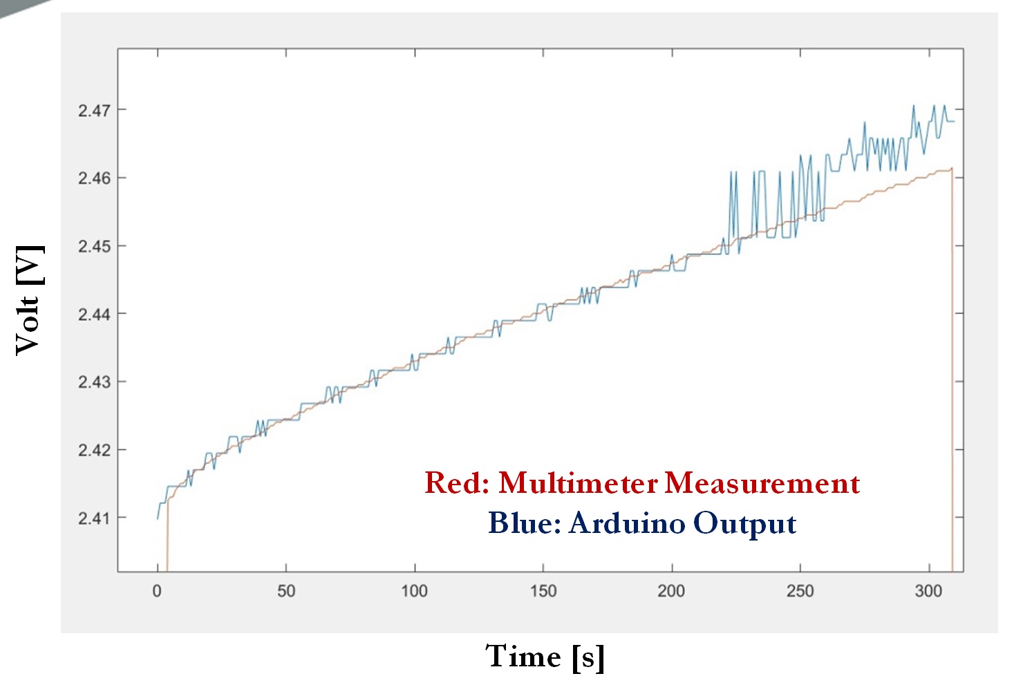

@raschemmel: I compared the battery voltage with the Arduino outputs before with a reasonable precision. Like I said I charged the cells close from nominal voltage and expect a slow rise. Also it cannot be the cell because the “jump” also occurs with other cell chemistries, following the same pattern. The start of the “jump” varies a bit (2.43V – 2.443V) but the upper value is always 2.46.

I tried today to use different ports of the Arduino, no success. But I narrowed down the error a bit: Next to the the figure with the whole circuit I attached my latest measurement: I connected the Vout of the OP AMP directly with the Multimeter and the Arduino (both measured against ground). The result is shown in test3.jpg. The OP AMP output is not governing the “jump”.
So it must have something to do with the Arduino or how it is connected? Should I upload these connections as well?

Your schematic isn't 100% clear to me. For one thing, you have two nodes named Vout but I know they're not connected to each other.
From the red arrows, however, it seems that you have a mode where you charge the battery through a FET/shunt which is controlled to provide a constant current?
Since your cells get ground through this FET/shunt you are putting a common mode signal at the inputs to your op amp. It sounds like this has the potential to cause the results you're seeing, although I don't have a good reason why it'd happen at the end of charge (when you'd expect the FET to be fully on).
Edited to Add: wait...no...if your FET was fully on at the end of charge, then you'd have 12V across your battery. I don't understand how your FET is controlled...

The OP AMP output is not governing the "jump".
There is no "jump" . That's the battery charging current reducing to "0".

Also it cannot be the cell because the "jump" also occurs with other cell chemistries, following the same pattern. The start of the "jump" varies a bit (2.43V - 2.443V) but the upper value is always 2.46.
That should tell you something, like , basically, any rechargable battery will no longer present a load once it's charged and your op amp will float and oscillate because it sees no load. (how can it with no difference of potential ? How can the output be pulled low if there is no current ? The only way to pull the output down when the battery is fully charged is to apply a lower voltage and start discharging the battery by sinking current instead of sourcing it. There are no other "options" You are either sinking current (discharging the battery), or sourcing it (charging the battery). You could alternate between the two to keep the voltage at some setpoint but if you simply command the op amp to an output voltage that is exactly the same as the sum of the two batteries, there will be no difference of potential and therefore no current. It's as simple as that. I can't believe how much you are making of a 15 mV fluctuation when the battery is charged. It's not showing up on your meter because it is averaging. Try changing your code to take 10 to 20 readings and average them and print only the average.
"Jump" = (2.47V-2.45V) = 0.020 V
(@0.00488 V/ per analog count, this is 3 counts)
Based on the step size of the voltage steps, the "jump" appears to be 3 "steps" or analog counts (3*0.00488 = 0.01464 V) or just under 15 mV.
To call a 15 mV voltage change in a 0 to 2.47V range a "jump" is just ludicrous ( because it represents a 0.4 % voltage change)
Total Charged Battery Voltage = 2.47 V
"Jump"(%) = 100* (0.015 V/2.47V) = 0.59 %

BigBobby:

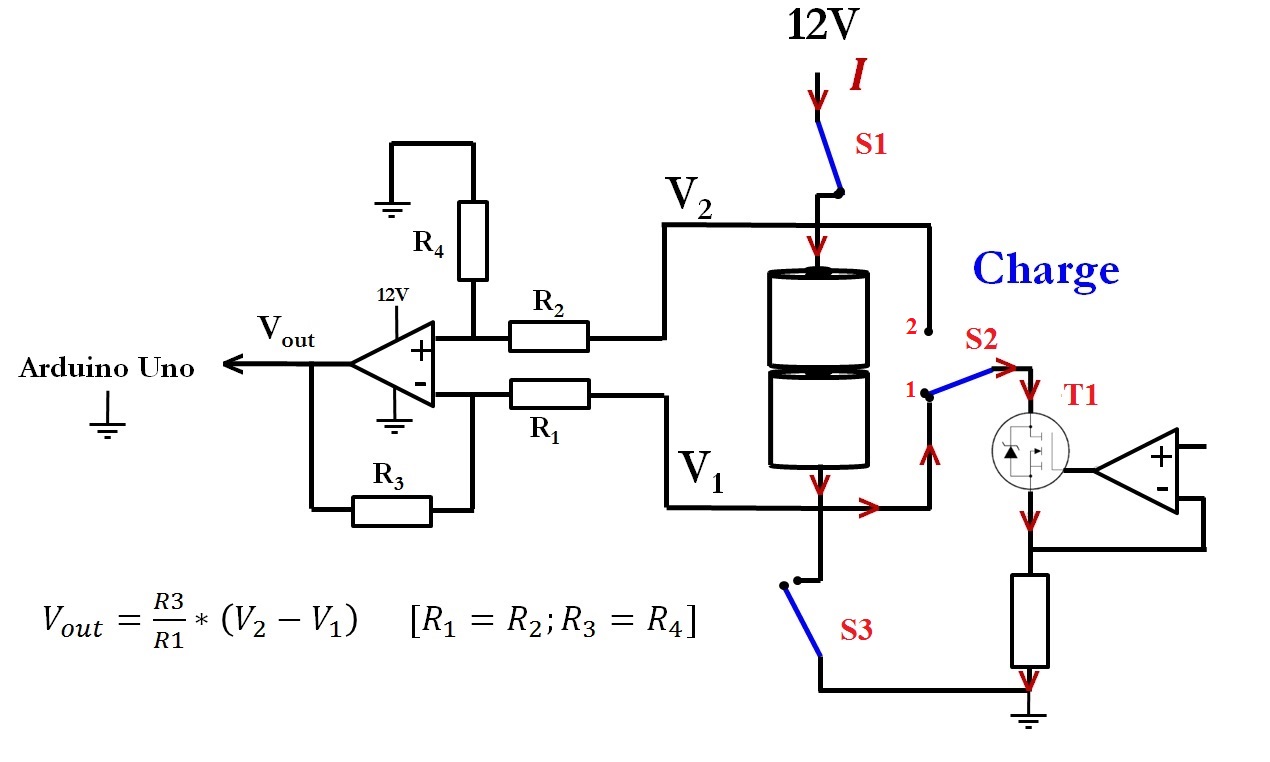

OK, I put some time into it and I understand now. If you don't mind, I added some labels to your schematic and reattached here. I'd post it as a picture, but my employer seems to block the free picture hosting sites (BTW - how little sense does it make that the forums will host the pictures as attachments, but not as pictures?).
Edited to add:
So if I understand your circuit correctly, T1 is a voltage controlled resistance that results in a constant current through your cells. When S1 is closed and S2 is in position 1, the cells are pulled up to 12V and T1 limits the charge current through the cells. When S3 is closed and S2 is in position 2, the cells are pulled down to GND and T1 limits the cells discharge current. Nice circuit.
It appears in your data you are always charging, which explains why your schematic shows the charging configuration. If your cells are balanced, they should be at ~1.23V. Are you sure they're both 1.23V? If they are, then they should be far away from end-of-charge where their impedance might do weird things.
It seems like your control for T1 must be unstable. As a test, when you see the A/D reading fluctuating like that, could you ground the + input to the amplifier controlling it to see if the A/D reading goes back to normal?
It also seems that the instability must be affecting your Arduino beyond just putting a high frequency on your cells. If your multimeter was just averaging the signal clean, it would be in the middle of the Arduino's samples where your Arduino samples are clearly higher. Possibly T1 being unstable could result in common mode signals getting through the op-amp, or maybe its ground currents aren't separated from the grounds of your op-amp and avr.
Seeing if the A/D readings go back to normal when T1 is forced off, however, would be the first step before figuring out how T1 is affecting your reading.

I also attached a complete circuit diagram of the current controlled battery simulator. Yes, the battery is floating. But since the OP Amp gives me only the differential voltage between the battery poles it should be ok.
If you are referring to the schematic posted in Reply#14, it is not complete. The comparator "+" input does not have any input voltage associated with it.
There is no part number for the fet.
There is no component type or value or label for the cylindrical object , (is that the battery ?)
There is also no circuit description for what appears to be a fet switched by a comparator and nothing more. Is that a modification or addition to the original op amp subtractor ?

The schematic certainly isn't complete, but it isn't that bad compared to other things posted to the forum.
Yes, the cylindrical objects are the two NiMH cells he mentioned in his post. The FET being controlled by the op amp measuring the current through the FET is almost certainly a constant current control. I was a bit confused by this circuit as I didn't see how he could achieve CC-CV charging, but then I remembered CC-CV is not how NiMH are charged.
He doesn't show the input to the current control op-amp. I assume it's a steady reference, but if it's not then possibly that's the cause of his problems.
Hopefully he comes back and answers, as it is an interesting problem.
There's no current control. That's a simple comparator. What is the cylinder under the comparator ? Is that a battery ? (or is it supposed to be a current limiting resistor ?)
