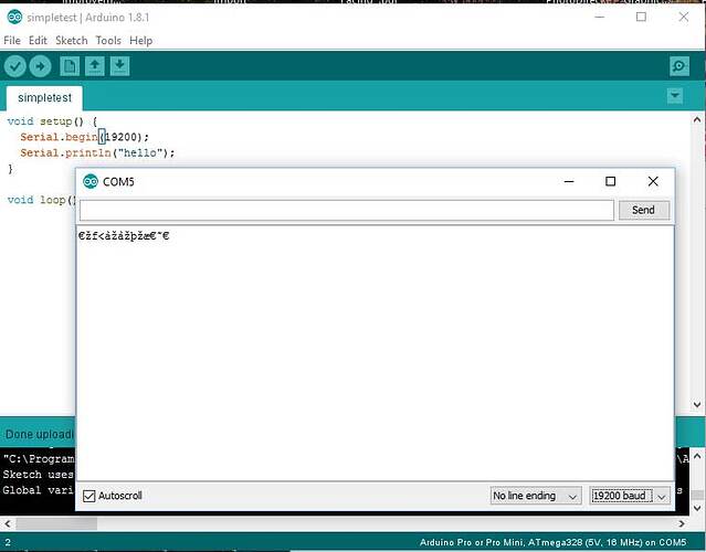

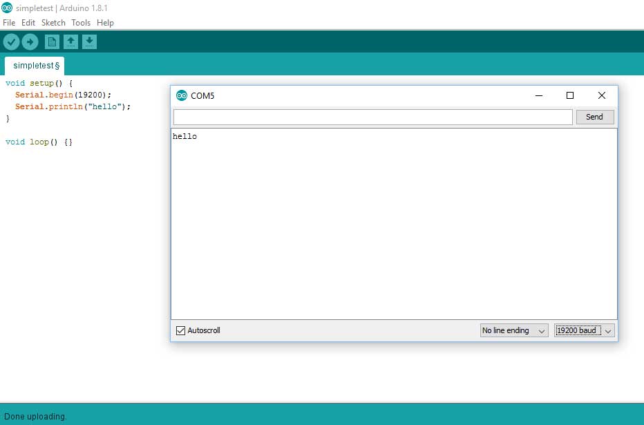

Thank you so much for your response. I uploaded the simple code and everything worked at 19200. But I tried changing the baud rate in the code to 38400 and the baud rate in serial monitor to 38400 and it would not work. When the baud rate was set in the code to 38400 it would only work at 19200 setting in serial monitor. (I disconnected Xbee before doing this)
My port settings for COM5 in my Device Manager are set at 38400 (for both tests).
Here are images of what I see in the serial monitor at 19200 and 38400.
This morning when I ran the test at 19200 it was no longer working correctly (see attached). It works at 9600, so only works at half speed. I sure hope someone out there has an idea. I don't know what else to try.

Just found out the reason for my problems. I had ordered three pro-minis for my project and 2 out of the 3 were 3.3v 8MHz. When I checked voltage it was, of course, the only one that was 5v 16MHz so I thought that wasn't the issue.
Lesson learned. Gotta have a discussion with my supplier. Thanks everyone who tried to help. I feel like, and am, such a noob!
I had suspected that at first but then the fact it was working correctly at 19200 but not at 38400 made me think I was wrong because it should always half the baud rate when the wrong value of F_CPU is defined.
