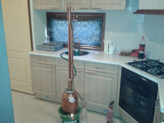

i make vodka , (moonshine )
never made beer ,,,
this is my distil before arduino use ,, LOL
like this post LOL beer and arduino yeaa :grin:

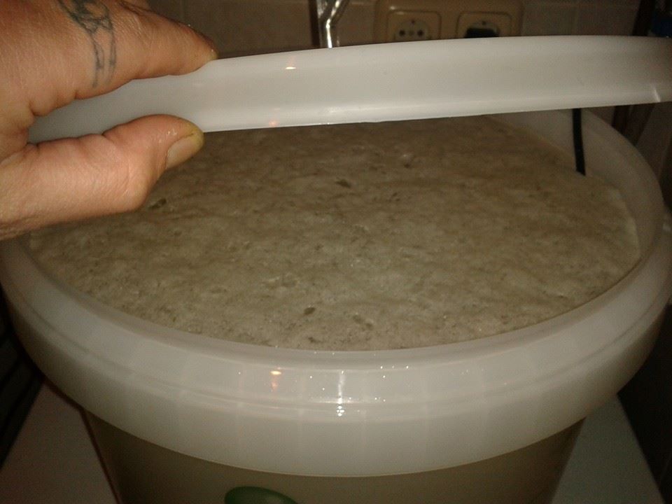

i also use a heater in my fermentation bucket , but i think you wil go bigger !

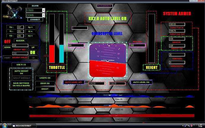

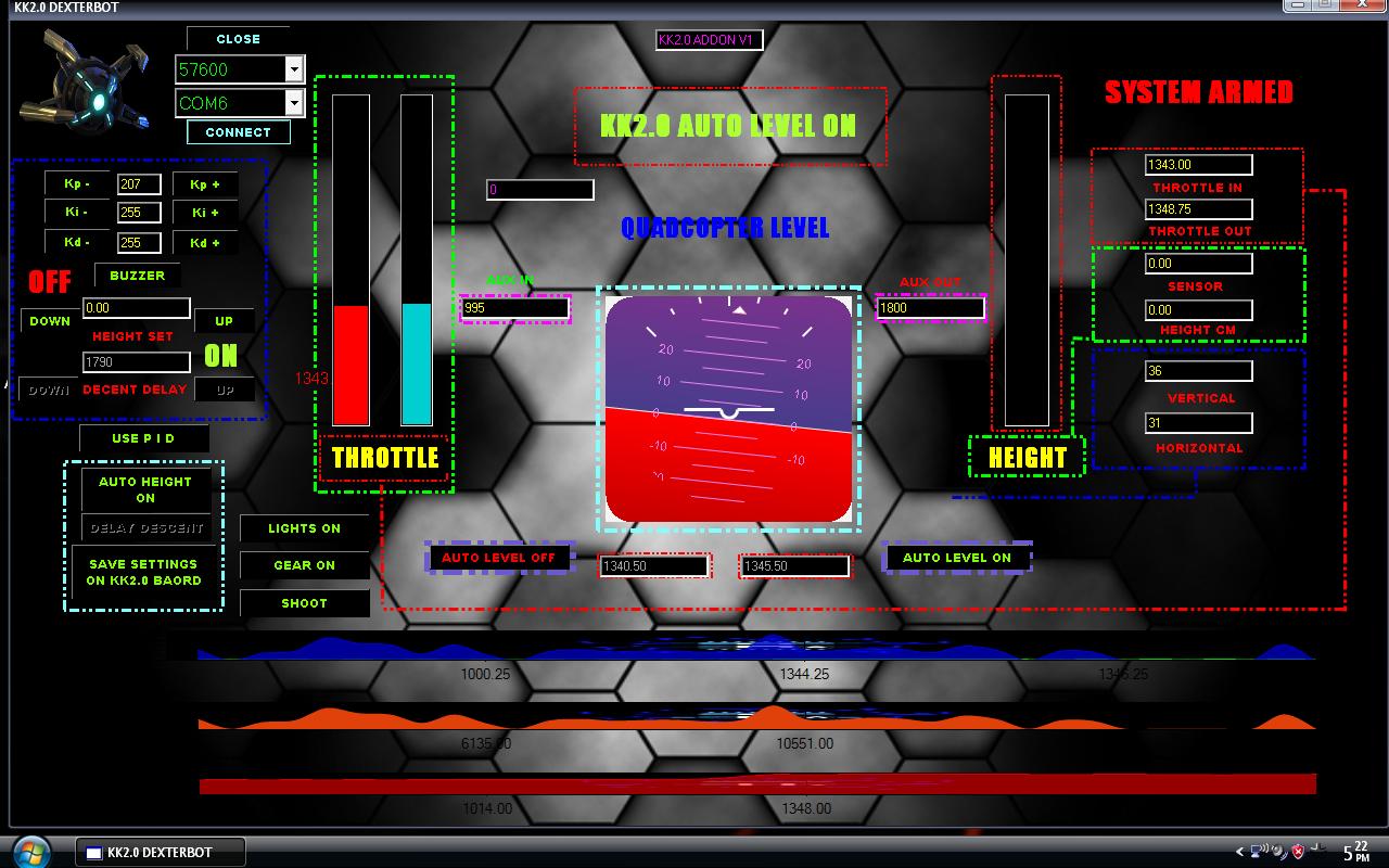

i use APC 220 module ,, tx rx 1000 meter range serial data ,,
maybe you can take a look at this picture ,, i use this for my quadcopter ,,
guages meters levels digits ,,,,,, you would like to have something like this ,,, but then showing the beer ,,
heat ,, temps , switches ,,, controls ,,
i wil like to help you learn program those things and build a logging GUI ,,
true VB ,, if you need help let me know , i am borred ,, :smiley:
full beer control system !
