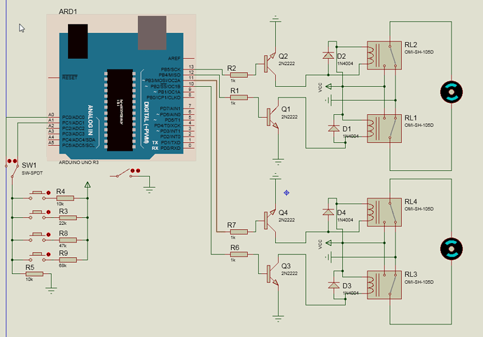

Since a few days ago by the user Arduino Uno and I made a couple of projects and almost everything I could from vido clips from joutube.
Now I tried to make something complicated project, at least for me.
I managed to get through 4 button and a few resistors make the analog input to -A0 who commands the relays at the outputs 13,12,11,10.
This match trying to find a way to change this code with several conditions.
The first condition:
If the pin 2 (LOW) read analog input from A0
if pin 2 (HIGH) read analog input from A1
The second condition:
If I'm reading the analog input A1
Powered some type of automatic mode and pin 13 (HIGH) for 20s or until you activate microswitches 1 or 2,
then activates pin 11 for a period of 5 seconds or until you activate microswitches 3 or 4
and so on until you activate microswitches 4 and 2 then activates pin 10 until you activate microswitches 3 and then pin 12 until you activate microswitches 2
microswitches 1 - the beginning of the path X-axis
microswitches 2 - end path X- axis
microswitches 3 - the beginning of the path Y-axis
microswitches 4 - end path Y- axis
Pin 13 - Engine 1 go left
Pin 12 - Engine 1 go right
Pin 11 - Engine 2 go left
Pin 10 - Engine 2 go right
I need help for changing the code

just a quick question, am I reading this right? Do you use a switch on the analog input?
If so, Why?
Wouldn't tt be easier to do it on a digital port?
The diagram shows the 4 button and switch that changes the analog pin A0 to A1.
when I worked Electronics will be two groups for each analog input A0 with 4 button on the A1 I put 4 microswitch.
Perhaps mode and instead of A1 to go via the digital inputs with microswitch.
But I can not write code that we include A0, when needed, and the second part is more important that we give conditions for the automatic mode when I choose.

I have looked at your code and at you nice clear diagram but I cannot make sense of your problem.
It is not helped by the diagram not having anything connected to pin 2.
And, as @Kevin77 says, why use analog inputs to detect switches when digital inputs would be simpler?

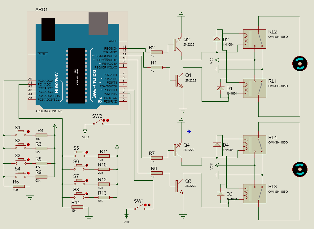

I will try to explain the concept
Pin 2 - LOW
	analogRead A0 and do not read pin A1
Pin 2 - HIGH
	analogRead A1 and do not read pin A0
this works - OK
	analogRead A0
push S1
	digitalWrite Pin13
push S2
	digitalWrite Pin12
push S3
	digitalWrite Pin11
push S4
	digitalWrite Pin10
S1,S2,S3 and S4 is http://cdn2.erusa.com/wp-content/uploads/2013/07/sw130_large1.jpg?0c0378
This we now need -
Pin 2 - HIGH
	digitalWrite - pin 10 - HIGH
until
	S8 - HIGH
Then
	digitalWrite - pin12 - HIGH
until
	S5 - HIGH
This is the starting position
Now
pin 3 - LOW
	not doing anything
pin 3 - HIGH
	doing this
	digitalWrite - pin13 - HIGH
until
	S5 - HIGH then
	digitalWrite - pin11 - HIGH
	daley(2000)
Then
until
	S6 - HIGH then
	daley(2000)
Then
until
	S5 - HIGH then
	daley(2000)
Then
until
	S6 - HIGH then
	daley(2000)
is repeated until
	S7 - HIGH
Then
until
	S8 - HIGH
Then
until
	S5 - HIGH
END
Pin13 - HIGH - motor1 run left 	X-axis
pin12 - HIGH - motor1 run right X-axis
Pin11 - HIGH - motor2 run UP	Y-axis
pin10 - HIGH - motor2 run Down	Y-axis
S5 - read switch - X-axis left
S6 - read switch - X-axis right
S7 - read switch - Y-axis UP
S8 - read switch - Y-axis Down
S5,S6,S7 and S8 is
http://www.chaldon.co.uk/wp-content/uploads/2009/07/4561.jpg
S1,S2,S3 and S4 is
BUTTON
S5,S6,S7 and S8 is
read switch

Pin2 - LOW
read pinA0
Pin2 - HIGH
read pinA1
this works pinA0
S1 - push
pin13 - HIGH
S2 - push
pin12 - HIGH
S3 - push
pin12 - HIGH
S5 - push
pin10 - HIGH
this works pinA1
pin2 - HIGH
read pinA1
pin10 - HIGH until S8 - HIGH
pin12 - HIGH until S5 - HIGH
Pin3 - HIGH
pin13 - HIGH until S5 - HIGH
pin11 - HIGH (2s)
pin12 - HIGH until S6 - HIGH
pin11 - HIGH (2s)
PIN11 - HIGH (2s)
pin11 - HIGH (2s)
S7 - HIGH
end
I'm trying to do something like this

what you are trying to produce is a type of a "finite state machine"
basically, the machine starts in state "0" (zero), which is, all motors off
if you press button "A" then the machine exits state "0" and enters state "5" (just an example)
state "5" ... starts 20 second timer and jumps to state "7"
state "7" ... motor #1 runs in clockwise direction ... also watches travel limit switch #1 and watches the timer
if switch closes or timer counts to zero, then got to state "0"
i hope that my description is clear enough
this may point you in the right direction
http://playground.arduino.cc/Code/FiniteStateMachine

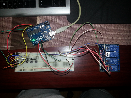

Here are trying to explain and re-write an existing project.
Framed in red working with the code attached

SW2 attached to pin2 (LOW-Manual mode, HIGH-Auto mode)
	if SW2 - LOW -> do Read analog pinA0 (framed in red) and pin3, pin4, pin5, pin6, pin7 not read
	if SW2 - HIGH -> do Read pin3 and pinA0, pin4, pin5, pin6, pin7 not read
SW1 attached to pin3 (LOW-STOP, HIGH-START)
	if SW1 - LOW -> set pin4, pin5, pin6, pin7 and pinA0 to LOW
		and pin10 to HIGH until pin7 read HIGH then pin10 to LOW
		and pin12 to HIGH until pin5 read HIGH then pin12 to LOW
	if SW1 - HIGH -> start auto mode
switches LEFT, RIGHT, UP, DOWN is Reed Switch - picture is attached
LEFT 	attached to pin4
RIGHT 	attached to pin5
UP 		attached to pin6
DOWN 	attached to pin7
relay2 	attached to pin13
relay1 	attached to pin12
relay4 	attached to pin11
relay3 	attached to pin10

I only exercised the conversion resistor value and the button for the analog input.
http://www.raltron.com/cust/tools/voltage_divider.asp
R1 - 47K
R2 - 10k
V -5v
1023/5=204.6
2.5v = 204.6*2.5 = 511.5 +-10% 460.35 --- 562.65 valve for button1
