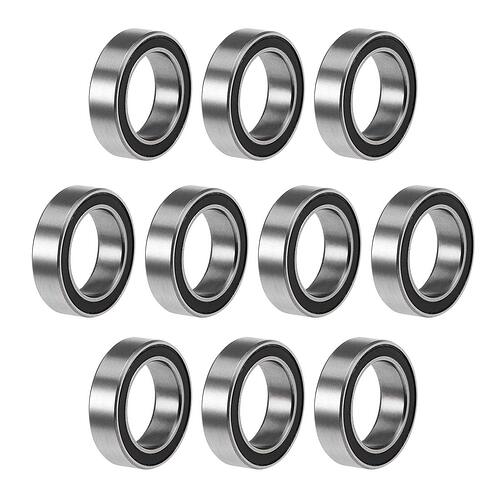

Bearings to support the weight and the movement. Your harmonic drive does not include either thrust bearings nor radial bearings, so what bearing are you using for your arm joints? Have you computed the weight that your joints will have to support?
How do you know that my harmonic drive does not include either thrust bearings nor radial bearings ? It looks like radial bearing.
At first glance, i will use the same bearings as the ones for the harmonic drive :
Yes, I have computed the weight for the joints.

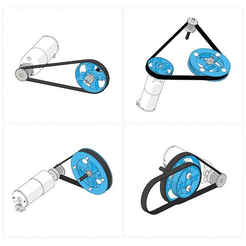

Also, how do you determine the exact distance between the motor axle and the pulley so that the belt is correctly stretched.
How do people usually do ? Do they permit the motor to slide before fixing it to adjust the belt tension ?
There is no exact distance since the temperature of the belt and other components will change along with the temperature. To allow for that the usual scheme is an idler pulley on a pivot with a spring to force the idler to keep the belt at the right tension. If the motor is moved to a new position, temperature will still make the belt length get shorter or longer.
My build is a home-made little robot arm, i don't think the temperature will really have a significant impact here, everything will be at around ambiant temp 25°C except de motor core which can rise at 50°C. But even that will not have an impact on the general structure which is made out of PMMA.
Also, here are my belts : (makeblock belt on google)
I will build my pulley like the image at the bottom left of my last message. There's no idler pulley in this case, how do i make the belt correctly stretch?
