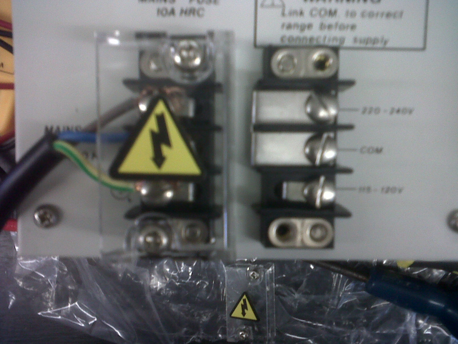

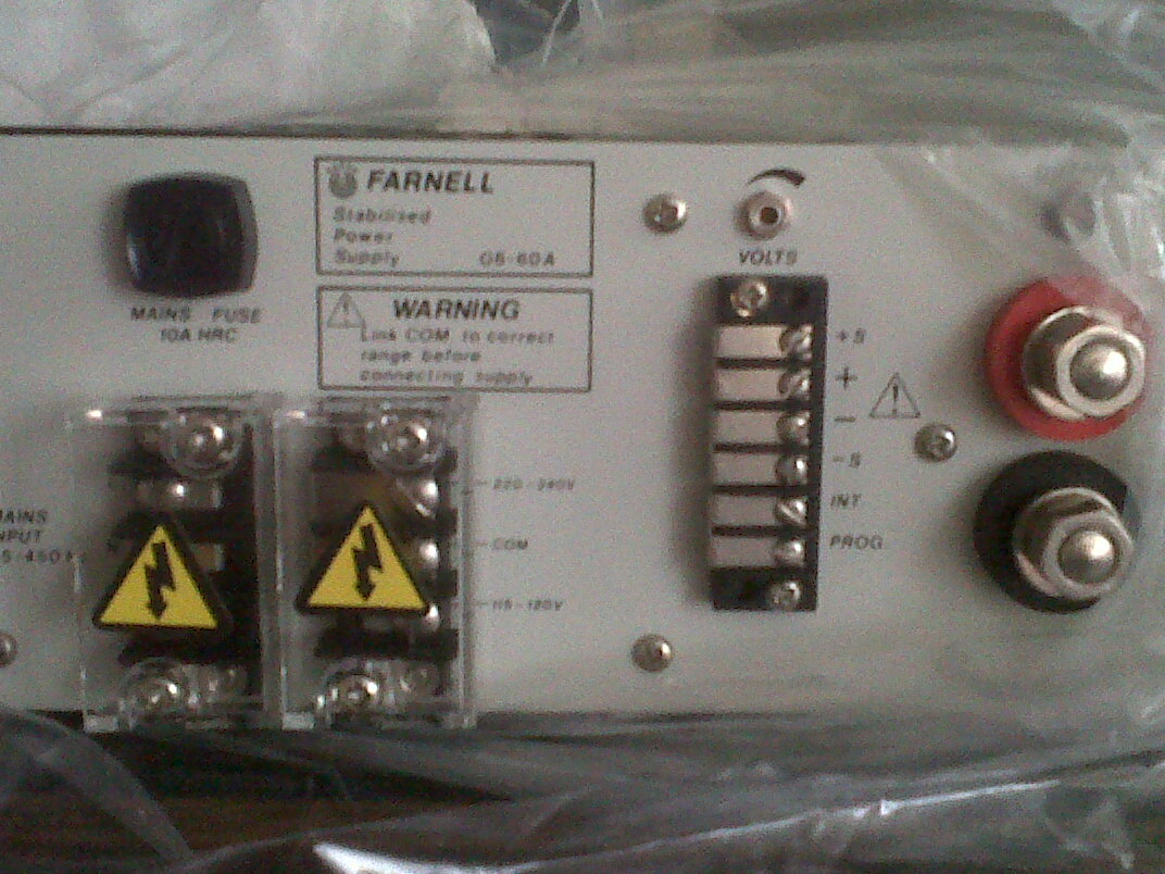

I'm trying to power a matrix of 64 servo motors through a board via a single power supply (it's separated from the Arduino board so I wont fry it). I've got the board and calculated the power required as 6v / 500mA x 64, so roughly 6v / 32amps. I purchased a power supply online that will supply 6v @ 60amps (so should be more than enough amps for the motors I'm hooking up). It arrived as a single unit without cables, etc and a slightly confusing (to a rookie) front panel that I certainly don't want to hook up incorrectly. Can anyone help point me in the right direction?
My guess would be to first buy a mains lead, clip the end connector off, and screw the wires into the appropriate terminals (on the left in the photo). The manual states to then link the mains to the appropriate voltage on the 3-way terminal block on the right (which is 240V as Im in the UK). How would this be done? Just a single heavy gauge wire from the live block on the left to the 240V block on the right? After that, I'm a little confused on what to hook up to what to get power from the unit to my board @ 6V.
Sorry for these rookie questions, just don't want to be electrocuted!
Just in case, the image attached is the front panel and the operating manual is here: http://3gcl.no-ip.org/3GCL/Datasheets/Electronics/SMPS/Farnell%20PSU/FARNELL.%20G6-60A.%20PSU.%20OPERATING%20GUIDE..pdf
Power cord goes to the left terminals.
Short jumper goes from the top screw (220/240V) to the center screw (COM) on the right to set the input voltage for 220-240V.

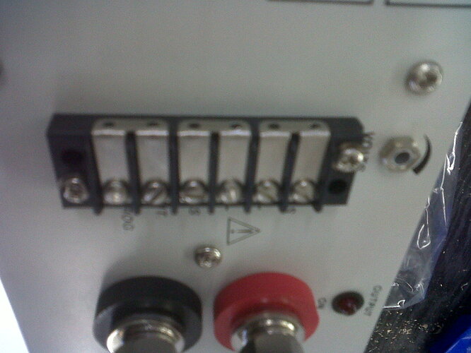

If you look at the schematic in the manual it shows a dotted line jumper from +S to '+', form -S to '-' and from INT to PROG. Install those three jumpers.
+S and -S are the 'sense' inputs for the voltage regulation. For critical applications with long wires you connect the sense inputs at the load end of the wires rather than the supply end. That way the regulator can compensate for power loss in the supply cables.
PROG sets the voltage and INT is the connection to the Voltage Adjust pot in the front panel. You hook them together to use the Voltage Adjust pot.

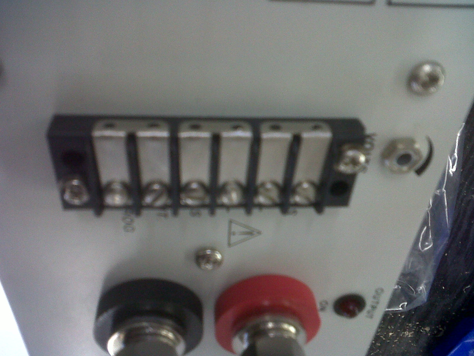

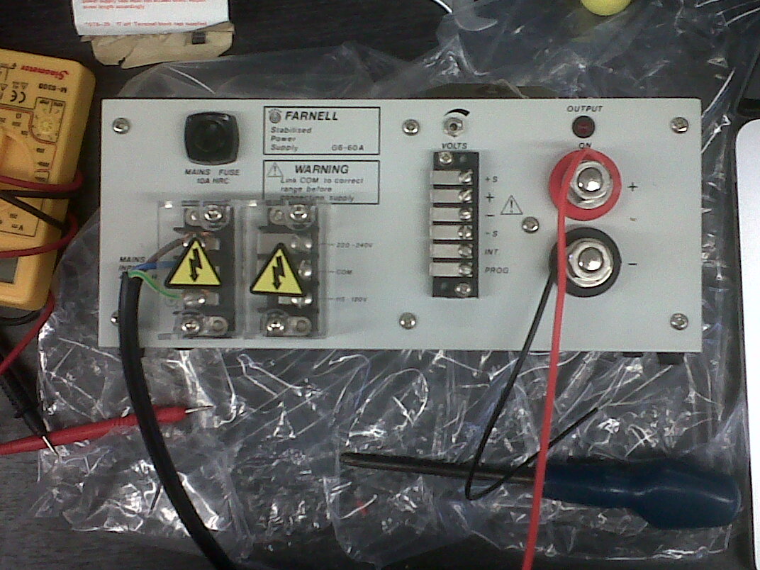

ok, i think i am ready to ramble. At closer look it appeared that the supply actually already had the jumper blocks attached to it in the combination johnwasser mentioned, so I just left them as was (see photos). I am using a mains plug with a 13amp fuse (but as mentioned by grumpy mike I suppose that isn't a factor with this voltage), and 12 gage (i think) stranded silver wire for the power hookups. Anyone see any red lights?
thanks again for the guidance.
Yep, those are jumpers.
The connection to the power cord would be better done with some crimp-on terminals but you should be OK for now.
Well, I just tried plugging it in and the output light fails to come on. Nothing blew, but after about 10 seconds it starts smelling like its going to fail. (I unplugged it). Any ideas on what it might be?
