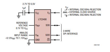

i am doing a project where i need to measure the output from an op-amp very accurately. i only need one channel. it will be in the mV range.
looking online i found these candidates:
24-bit ltc2400
16-bit ads1115 (4 channel)
24-bit ads1254
i'm looking for the best thats arduino comatable with either i2c or spi. i think the ltc2400 is the best/ most accurate.
am i overlooking a better chip? i'm looking for a sub 20$ chip.
any help on this problem is appreciated. thanks!

@railroader this device is powered by a 3.7v lipo battery. could i use something like the TI REF3012?
the ltc2400 has support for a voltage refrence input. i'm unsure yet of the range, but i think it will be safe to say 0mV to maybe 600mV?
ltc2400 datasheet
Measuring voltages from 0 to 600 mV doesn't call for any extrodinary ADC. The 10 bit ADC in an UNO provides 512 levels.

so i need about 0-600mv range (0-800mv absolute peak), but need it to be as precise as a good multi-meter, if not better.
i.e. resolution of 500.00mV measurement capability, with it being accurate to 500.0mV or better.
i hope i'm explaining this correctly. thanks

So you need accuracy of 100uV and resolution of 10uV? What is the application? What voltage reference and what op-amp do you plan to use to achieve this level of accuracy? How will you design your circuit to be noise-free to those levels?
ok. in the simplest terms possible i want to measure the voltage generated by this project: uCurrent
its used for measuring precision current.
i am creating a very modified version of this, but that should show what i need it to-do.

am i correct in this thinking? i will admit i'm rather new to analog design (eeng student, but haven't taken analog courses yet)
@paulrb i will be using precision op-amps (set of MAX4239AUT)(0.1uV offset), with precision resistors. the arduino is optically isolated, the measurment side is powered using battery, and the whole thing will live inside a small alluminum enclosure.

This does not make sense. If you say resolution of 500mV or 500.0mV or 500.00mV that's the same thing. I think what you mean to say is a resolution of 0.01mV. In other words the ability to distinguish 499.99mV from 500.00mV from 500.01mV. Correct?
For that level of resolution, you will need 600 / 0.01 = 60,000 distinct values from your adc. That's 16 bits resolution.
that is 100% correct. my bad for bad explanation. however, i'd like to have a bit more room, so i would like to be able to go up to 800mv, so 800/0.01 = 80,000
16-bit is a definite option. thanks for showing the math formula.
from the adc (of the 3 originally mentioned) that i'm looking at, the cost between a 16-bit and 24-bit are negligible. (of the two mentioned below, one is spi and the other is i2c. spi optocouplers are cheaper than i2c, so cost can be made up there).
i'm looking at the 24-bit ltc2400 as the most viable option (10$), vs something like the ads1115 which comes in at (6$)- which does not have an onboard option for a precision voltage refrence.

The ADS1115 is actually 15 bit only (the 16th bit is parity, and only applicable when doing a differential measurement).
As you want the 16th bit, I'd be looking at ADCs that offer more than 16 bit resolution.
Noise is indeed going to be a problem for that 16th bit, you have to design for that.
How is that OpAmp (which OpAmp? they also produce noise themselves!) going to be connected to the ADC?

ok thanks. i think i've decided to go with the 24-bit ltc2400
as for op-amps, i will be using precision op-amps (set of MAX4239AUT)(0.1uV offset), with precision resistors. the arduino is optically isolated, the measurment side is powered using battery, and the whole thing will live inside a small alluminum enclosure.
the battery is a lipo, 3.7v
as for how to connect the op-amps output to the adc, i have no idea, as i am admitedly rather new to the world of analog design. see below as to how i currently have it connected.
i plan on measuring low voltage ac (isolated), and dc signals all of which have the potential for positive and negative voltages. how would i account for this on the ADC connection? i know that ADCs don't necessarily like negative voltages. will this even be a problem?
here are the main 3 parts of the analog side. +3.7v goes to +Vbat, -3.7v goes to -Vbat, and im generating a virtual ground.
LTC2400 DAC Datasheet
max14850 optocoupler Datasheet
ADR4520 precision voltage refrence Datasheet
where should i connect the FO pin?
and here is a link to the schematics in a gallery for higher resolution: Gallery
if anyone wants to see the full design, im happy to share but its just digital stuff.
thanks!
